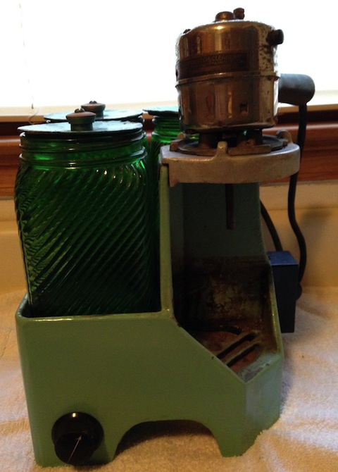

DOES ANYONE HAVE A WATCH PARTS CLEANING MACHINE BRANDED - SUPERIOR WATCH CLEANER - PITTSBURGH PA?

THE MOTOR ASSEMBLY WITH THE BASKET IS PLACED IN EACH JAR SEPARATELY BY HAND. I AM GUESSING THERE IS AN ADAPTOR OR LOCKING RIM OF SOME SORT (SIMILAR TO THE 3 JAW LOCK ON THE HEATING CORNER) THAT ATTACHES TO THE JARS BEFORE THE MOTOR & BASKET IS USED. OTHERWISE IT WOULD BE TOO EASY FOR THE SPINNING BASKET TO HIT THE SIDE OF THE JAR AND BREAK IT.

looking at your machine i see what appears to be a brown colored gasket below the heater locking ring. is the surface where this gasket sits tapered? if it is tapered that would lead me to believe that the machine is friction fit into the mouth of the jar. that gasket is there for a reason.

Hi Todd,
Yes slightly tapered but quite a bit smaller than jar opening. I still think there must be a rim to protect the glass?

100% sure Todd. There is a 1/4 - 3/8" of play between the gasket and the jar neck. There had to be a metal "cap" that went on the jar with a tapered internal opening to take the basket/motor which likely locked into place with a bayonet mount like you see at the drying corner. Otherwise, as soon as you let go of the wooden handle it would tilt & hit the side of the jar.

do you happen to have the same green glass jars i do? if you do and you can measure the taper of the mount accurately i could make you a screw on adapter. i may be new at this watch repair thing but i am quite skilled at making custom parts. i am attaching a pic of the
OD measurement of my jar.
