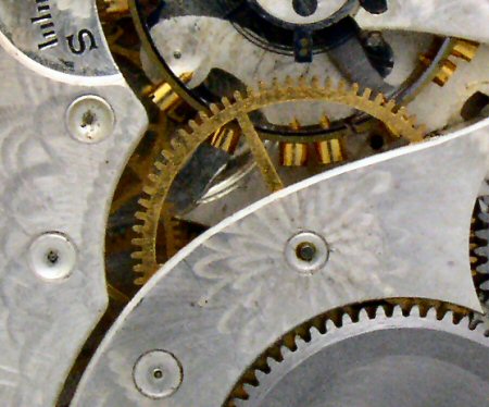

Whats your opinion, are these pivots dirty?

I don't know. I tried my loupe and all I saw were pixels. The plate screws are off-screen, so I couldn't take it apart to look any closer.

From what you could see in the photo, would you take this movement apart and clean the pivots, or?
No record of the last service date is available, but the Elgin is running well and keeping accurate time.

If it were my watch and i did not know of last service, i would be safe than sorry and get it cleaned and oiled.

I copied your picture into my Top Secret browsing folder and disassembled the watch.
I agree with Kevin because I found old, gummy oil contaminated with dirt that was wearing away at your pivots. Smile

They look dirty to me also. Did your Top Secret browsing folder determine the size and s/n?

I could only load what was in the picture. There was sufficient information for the secret algorithms to determine it was a 12s, 7J and possibly grade 301. Big Grin

As I often tell people, many "pearls" of wisdom have been offered through the years on these message boards, and most are still available, for those with the initiative to look, read, and learn.
For example, you might consider reviewing my reply in the topic below, and then taking another good look at the pivots in your watch. Perhaps you will find some pertinent information, which will answer your question, and save you from making a costly mistake.

You were very close, its a 12S 7J Grade 303, and any Elgin deserves cleaning/oiling before put it service.
Steve.
Thanks for the information, a watch with this much dirt around the pivots certainly should be taken apart, fully cleaned and oiled, even if its only 79 years old. An Elgin takes a licking and keeps on ticking.

The point I was attempting to make is that a part of the "dirt" you see around the pivots in your watch (especially around the center pivot) isn't really dirt at all, it's the metal from your pivots slowly being ground to dust.
When deposits of this nature begin to emerge from pivot holes, it's a sure sign they're starting to self-destruct, and service is well past due!
Think of it as draining the oil from the oil pan in your car, and seeing the oil pour out with metallic flakes in it. It means that something is going horribly wrong, and if measures aren't taken immediately to correct the problem, it will soon result in even larger headaches.
