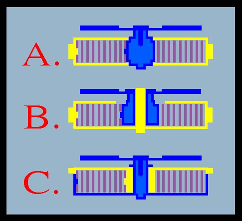

In the sketch below, figure "C" is a cross-sectional view of a Waltham "Safety Barrel," which in the jeweled versions, comes apart exactly as Ed described. The sketch below shows the non-jeweled version, but in the jeweled version, the lower pivot of the barrel arbor unscrews from the rest of the arbor, and releases the steel part of the barrel.
As for the Lancaster staffs, I have no idea where you'd be able to find any of those. I'm about 99.9% sure that Hamilton staffs won't work, but I suppose it couldn't hurt to measure one and see.........
