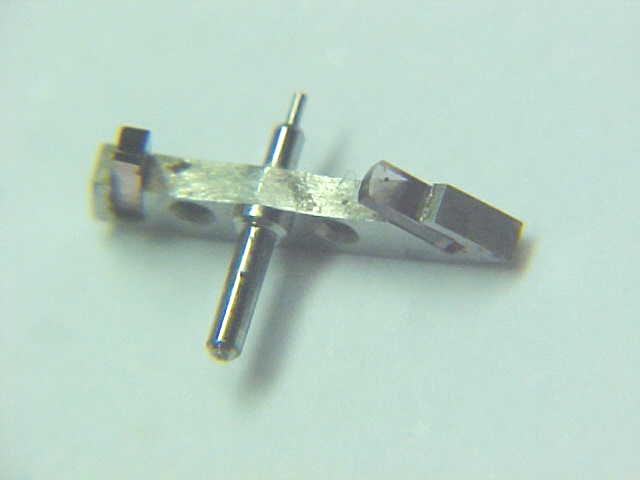

Hi All,
I am trying to fix a Waltham Broadway and I keep breaking the pallet arbor while trying to put the plates together. This pallet is different than what I've seen on the previous 18s I've worked on and it's top heavy. I can't get the top plate on without it getting sideways. After that when I try to lift the plate the arbor seems to be stuck and I've snapped two of them. Any advice, comments, or suggestions will be helpful.
Thank you,
RR

Roger J. NolfeTwo things: You can use a small piece of Rodico to hold the pallet in place as is suggested elsewhere in the forum. Second, when separating the plates, be sure you lift the correct plate. If you lift the plate with the lower balance jewel, you will likely twist and snap or bend the pivot and or crack/break a jewel.
Roger

Samie L. SmithWith the movement apart check and see if your upper and lower pallet jewels are the correct size for the pallet arbor you have,,If you have had too replace the arbor the jewels may not be right.ain,t watch repair fun

Try puting the wheels and palet in the upper plate, then put the pillar plate on.

Richard RomeroEveryone thank you so much for the help. I'm going to try what Brian is suggesting with some Rodico that Roger suggests. I'll make sure to also check the palate before attempting to assemble which Samie suggested.
