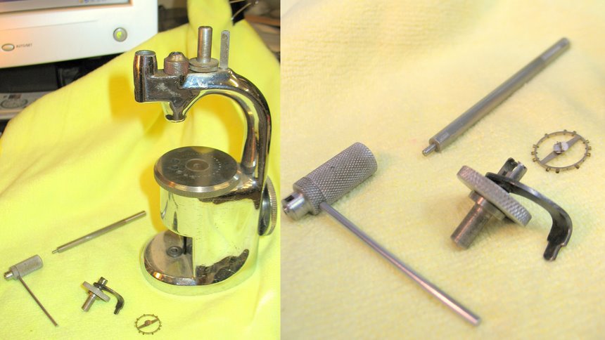

In response to a member question about removing balance staffs, I am attempting to address this question in more general terms. I must warn the reader that only "practice makes perfect" and with that I go on. Most staking sets made by K&D, etc. have with them some odd looking tools which are in fact at least 50% of the reason we use a staking set. These are Balance staff and roller removing tools and stakes. Some balance staff removal tools came with an instruction sheet that looks like this . . .
June 26, 2010, 11:53
David AbbeAFTER removing the Balance Hair Spring which can be done several ways, it is wise to locate from your staking tool set those tools necessary to complete the removal of;
1. The Safety Roller(s)
2. The Balance Staff
June 26, 2010, 11:55
David AbbeFirst, You install the Roller Removal tool in the largest hole on the staking tool set aligned properly so that by using the right stake you can gently tap out the roller(s) being careful not to break off the Roller Jewel.

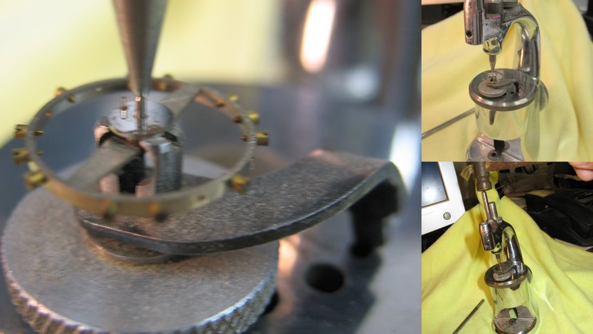

David AbbeThen according to the balance staff remover instructions shown in the first part of this above(
), you find the correct hole in the staking tool platen to just barely clear the bottom end of the balance staff, assemble the staff remover so that it tightly clamps the wheel to the platen and will locate the punch correctly on top of the staff and wheel.
Briskly tap the removal tool punch with a brass hammer to knock out the staff.
you CAN remove the staff the same way without this tool, but you will llikely damage the balance wheel by bending the cross arm.June 26, 2010, 12:01

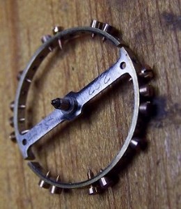

David AbbeIf you have done all of this carefully, you should have a good wheel ready for re-staffing, and a good safety roller(s) for later assembly and restoral of the watch.
For this demo, I used a swiss fake wheel of no value so no live Balance staffs, wheels or rollers were injured or killed in this exercise.Putting in the new staff is covered pretty well in "The Watch Repairer's Manual by Fried, and the Chicago Horological school booksJune 26, 2010, 19:09
