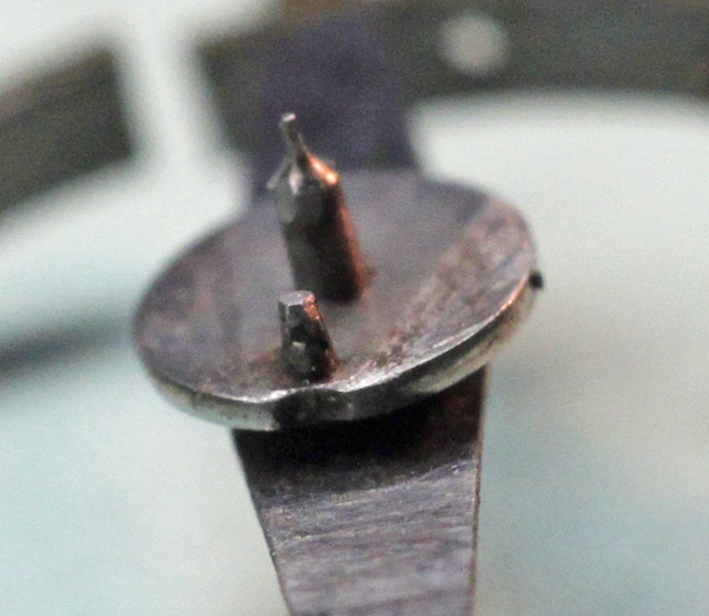

Robert McClellandI found a balance wheel in my junk parts drawer that had a steel roller 'jewel' installed by someone. You can see from the photo that the end has some significant wear. I'm sure the performance would definitely have been compromised.

Serge BarlasRobert,
I have seen the same thing but with a piece of brass rod in place of the jewel pin. Why would someone go through all the trouble of making a brass "pin" to fit the watch when it would have been less work to just replace the jewel ??
