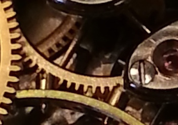

Now; this Pocahontas was a runner going in to the project and I hated to tear her down, but she is headed out the door and I wanted to be able to say she was 100%. While it was apart, I noticed the escape wheel had odd wear... I had a good spare with a bad staff... so, I got to do my first wheel swap.
So, being all proud of myself for about a whole two minutes... then she stopped... just stopped... at random intervals... 2 minutes, 20 minutes... what ever... it acted like it was "over banking" but would start back up if I looked cross eyed at the escape wheel...
So, being convinced I did something wrong when I swapped the wheels... I tore the whole watch back down.. even the cap jewels... trying to figure out what was amiss.
This time it went back together and the escape would not advance at all... The pallet fork would toggle, but the escape wheel would not advance... all free spins checked out good.
The third time I repeated all jewel and assembly checks... I finally noticed daylight behind the pallet jewels.
I reckon it ain't supposed to be there.

Michael BriggsSpace behind the pallet jewel to the back of the slot that holds the jewel allows for adjusting the jewel forward or back in the slot to adjust the escapement action. The presence of space isn't a problem -- the amount might need to be changed if the engagement of the jewel with the escapement isn't correct.

Roger J. NolfeMaybe it's just the picture, but it sure looks like there is a missing tooth on what appears to be the fourth wheel. Also looks like some tooth damage to the right of where the missing tooth is.

Paul D. TrombleyWhat a difference a gazzilianth of an inch makes.
I had the luxury of having the Chevy and Cadillac models side by side. I studied the lock and unlock of the Iroquois and compared to the Pocahontas.
The left jewel of the Pocahontas was just barely not clearing the tip of the toe that trails the arm on the escape wheel.
I pulled the pallet fork and scrutinized it thoroughly. The jewels were perfectly parallel and solid in the hands of the scorpion. No reason to suspect they had drifted forward out of their seats. The fourth wheel and escape wheel suffered similar scrutiny. The appearance of an issue with the teeth on the fourth wheel had to do with the camera angle (eg. shadow) and masking by the balance wheel weight..
I rotated the outboard banking pin less than 5 degrees open as indexed by the screw driver slot... put the pallet fork back in and got great results.
The pallet snaps left and right with the lightest flick of the scorpions tail. engagement to the escape wheel is on the short side of 1/3, but is essentially identical to the Iroquois...
Installed the balance and off she went... just like she never had an issue.

Eugene BuffardI think Roger is on to something. The watch in the photo is MISSING at least 1 tooth and about 3 bent teeth. Let me guess a broken mainspring also.
With this many messed up teeth it WOULD STOP radically at different times.
GOOD EYE RODGER.
I would also venture to say that when the mainspring broke. It put so much stress on the third wheel it ripped a few teeth. and maybe bent the arm of the pallet fork trying to hold all of that force.
and that is why you had to adjust the banking pin.
February 07, 2014, 07:01
Roger J. NolfeNot quite that good Eugene. Paul explains above that shadows from the balance screws makes the teeth appear missing/damaged.

Eugene BuffardI was wrong again. I'm happy you got it running.
