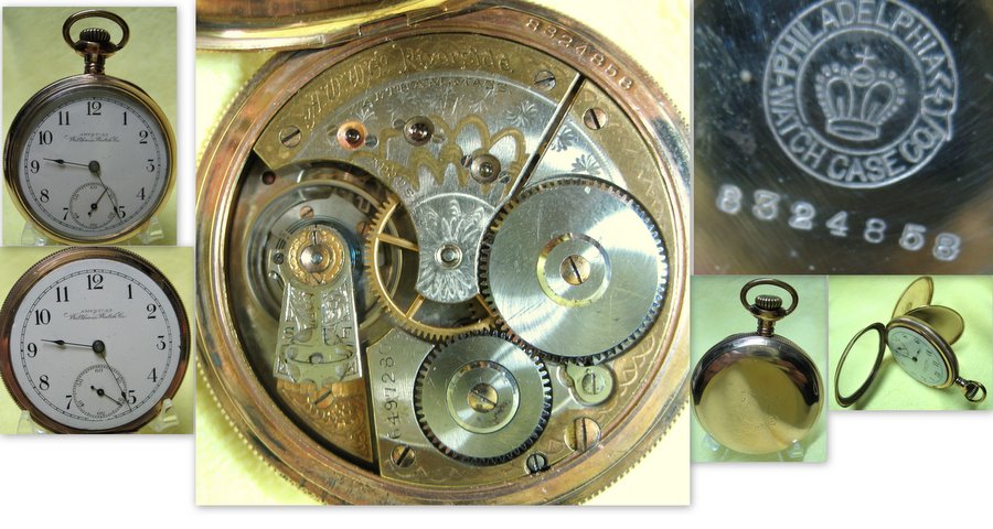

Dick, we must be on the "same channel" I am getting ready to clean up this 2-tone Riverside and have some puzzlement about the "Gold" tone. I hope you post some pics of yours with comments. I will do same after cleaning.
January 17, 2009, 14:04
Edward Kitner
Nice 88 David!
I do like some of the two tone movements. Pair that with the classic mdl 1888 and you have something.
