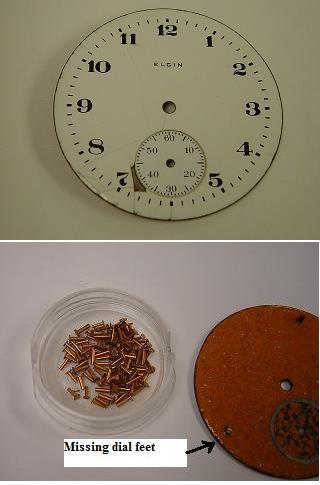

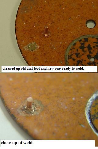

Leon HarrisHi Ernie, I have used my Laser Welder to repair dial feet before with a good outcome. It does get alittle tricky with a very rare or expensive dial. The first picture shows a damaged Elgin dial with a broke dial foot. The outer pictures shows the welds. Take a look and tell me what you think.
Leon

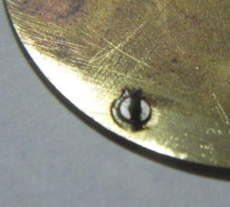

Leon HarrisThis picture shows the back of the dial and weld.

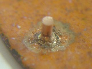

Leon HarrisClose up of the laser weld this is done while I hold the dial in my hands so I can feel if the dial even starts to get warm. On most dials you can use a wet paper towel to keep the heet down and not mess up the dial.

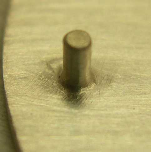

Here is the dial with glued feet
February 19, 2009, 21:41
