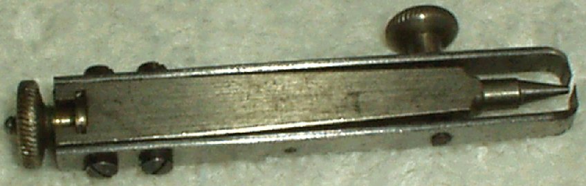

Would this type of tool work well to remove the roller plate?

February 21, 2003, 14:14
Steve Maddox
That's not my favorite type, but it should do the job!

I've never used the roller removal tool you have pictured. Does it have just the one end that fits against the balance pivot shoulder? If you intend on using the balance staff again, make sure the opening isn't too small and the nose is rounded.
I use a Rex roller remover that comes with round nosed stakes that have .11, .15, .20mm hole openings. It was designed so that you could remove the roller table without damaging the staff pivot. If yours is designed for pocket sizes, it probably has an opening somewhere between .15 & .20mm. Some staking sets have roller remover stakes and punches included.

Thanks John for the information. This tool appears to work well, but I just got a Rex Roller removal tool, so will try it next.

Another roller remover tool.
