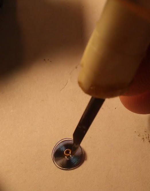

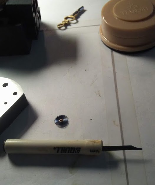

It looks like 2 things or 3 , 1 treat a balance and hairspring like a live bomb , 2 close collet with spring off balance , 3 use tool to adjust collet , that will keep you busy but it can be straightened , try this tool made from old mainspring heated to take out temper , grind the tip to shape, epoxy in old ink pen tube
October 21, 2018, 14:29
Kevin Hoffman
use like this , just imagine it is on the balance , I hope this is what your asking , I get accused of telling you how a watch works when you only wanted the time

Yepper.
When I did the damage the collet had gone through the concave punch step, off the wheel.
I used a hole punch makng sure the pivot had space. Even the lightest tap THEN INSPECT, need more? Another light tap, INSPECT.
The closing distance is real small. I treated it like the wheel arms WOULD NOT DEFORM in the hole really too big in the Staking anvil. I need next time to think of the best way to support the staff very close to the force, and make the balance arms not be the recipient.
I must of hit it 3-4 times never looking, figuring it ‘would bottom out’. Sadely it was home probably on the first hit. Then after those 3-4 I gave it ONE LAST ONE.
So now I have a few 7j Grade 96 Elgin 18’s to decide who become the doners! I LUV it.
The tool You made from a main spring is a great mod with a part that would just get tossed.

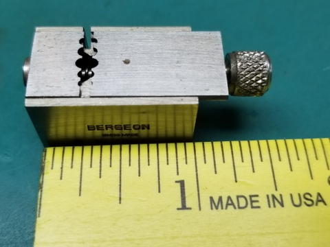

For every job there is a tool or many tools from different suppliers. After you've spent thousands of dollars on tools you'll think you have all you need, but you don't if you get addicted. Here is a Bergeon hairspring collet closing tool.
And if you need to rotate the collet on the balance staff, there are tools for that too.
