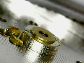

so, i disassembled my beautiful new york standard movement that i just received yesterday in preparation for cleaning in my beautiful cleaning machine. but, i am stuck. the hole and cap jewel of the balance that are mounted in the plate seem to be mounted via a screw ring of some kind. i know you cant see it in the pic but the jewel mount sits proud of the mounting ring. do i need a special tool to unscrew this ring or can i just mod a screwdriver so it can reach both slots without touching the jewel mount? the jewels obviously need to come out for proper cleaning. the movement was filthy.

I believe that jewel just presses out with a stake from your staking set (or a jewel pusher).
Someone more experienced can correct me if I'm wrong.

before i attempt to push out the jewel i am going to reassemble the plates and balance to check clearance re: the positioning of the depth of the jewel. as i mentioned before the jewel sits proud of the mounting ring so i think if i check balance shake before i start i should be able to put the jewel back properly.
attaching a pic of the position of the jewel mount in relation to the mounting ring.

so i put the plates back together with the balance. the balance spins freely with almost zero side shake or up and down play.
i am now going to try to push out the jewels.
i think putting them back may be a heck of a challenge.
wish me luck!
Todd

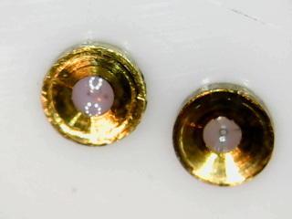

i would say these jewels are pretty filthy
going to peg them then into the cleaning machine they go.

after cleaning.
thats' better!

I hope I'm wrong, but both your before and after cleaning pics of the hole jewel seem to show 2 cracks going to the hole. If this watch is to be a 'carry' watch then that jewel should be replaced since the cracks have probably left an almost imperceptible sharp edge in the hole that will wear away the balance pivot as it turns in that hole 18,000 times per hour. If the intent is for only occasional use, then you can get away with leaving it as is.

i saw that, actually there are 3 cracks.
everything i am working on at this point i consider to be student watches. i am purchasing non runners for the purpose of learning and improving my skills. once i have one of them running well it goes on the shelf and on to another. i have in mind what i want for a carry watch, but i don't yet have the skills or confidence to work on something valuable or rare. i would not want to ruin a rare watch. that is why i am purchasing junk non runners. if i make a mistake and destroy one i will not feel bad. if i ruin something of rarity and beauty i would be quite upset. i expect it will take at least a year before i have even the most rudimentary of skills but i am coming along quite nicely with the help of everyone on IHC.
