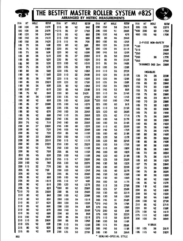

Here is a list of some common roller tables .
Perhaps you can find one that will suit the situation.

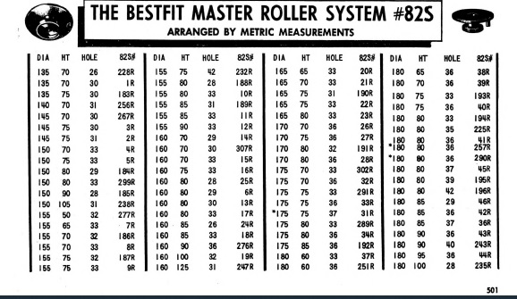

Melvin Siedman
More of the list
