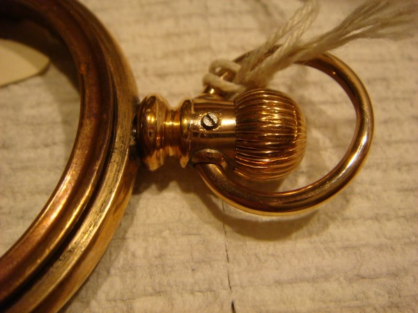

Mike I didn't have a hunter case but this one will give you an idea of what kind case you are looking for..This is a shot of the female stem..Hope they help..

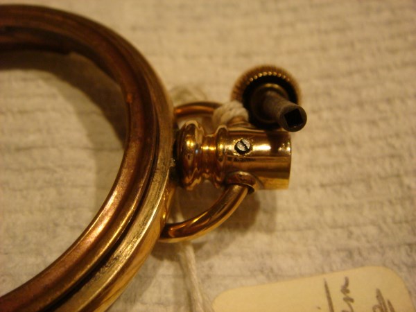

August 12, 2014, 17:03
Gary E. Cochran
Pic 2..Screw that's holds the stem in the case..

August 12, 2014, 17:30
Mike Haig
Gary, a picture is worth a thousand words.
Very clear and easy to understand.
Thanks for your help and taking the trouble to post the photos.
All the best, Mike
