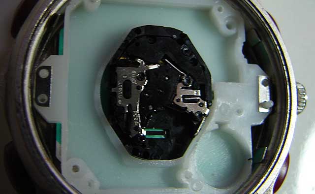

Roddy J. BruntonHi Chris, You were right of course. However, not being a watchmaker, when I went to reassemble the watch after changing the 2nd battery, I noticed 2 little springs & a 'clip' of some sort had come out & I have no idea where they go. I guess I should have left it alone. I guess now I'll put all the bits into a small baggie. Rod
September 17, 2011, 14:40
Chris AbellPut it the project draw you can always go back to it another day now its near fixed
if you have photos of the parts and the upper board removed we maybe able to figure where they go, I can see one spring in your photo is that one?

Roddy J. Bruntonhere is 1st pic
September 17, 2011, 16:07
Roddy J. Brunton2nd
September 17, 2011, 16:08
Roddy J. Brunton3rd
September 17, 2011, 16:09
Don't know if these pics will help or not.
Regards, Rod

Roddy J. BruntonI think I worked out where they went...
September 17, 2011, 16:33
Roddy J. Bruntongot the springs back in & the clip, it went in the main battery opening. put in the 2 new batteries.
And now nothing works? Now I do give up!

Chris AbellTake the circuit off and see if the analogue works on its own. you may have not aligned to circuit spot on to make contacts with the black strips.
I take it springs re photo 1 at 1 & 7, and clip in round recess in white plastic small tab uppermost
September 19, 2011, 23:40
Roddy J. BruntonHi Chris, That didn't seem to do it either, now nothing seems to work. First one worked then I changed a battery & the one started working but the first one quit. Changed the second battery now nothing works, I just don't get it.
Rod
