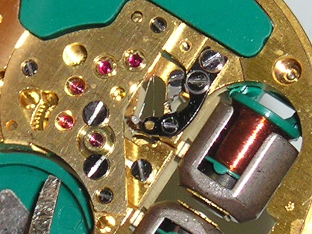

Chris AbellCan you get a good close up photo of the index & jewels?

David J. RudaryHi Chris,
The index jewel and pawl jewel spings are straight and the jewels are hitting the index wheel at a right angle, not out of line with the jewel springs, in other words jewel and spring form a straight line to the index wheel. The jewel springs are centered on the index wheel so the guard swings in w/o incident. I will post a pic as well.

February 15, 2009, 09:49
David J. Rudary214 index jewels on the watch in question.
February 15, 2009, 19:21
Chris AbellHi Dave,
Still hard to see even with such a good photo, looks like you are not the first visitor here with all the screw heads chewed up and jewel rotated where shoulders cut away. From what I can see the stress limiters and to close to the index fingers I would give them a slight angle away maybe causing secondary and un-natural vibrations. Of course a full strip clean of the train and index wheel maybe a good thing, does it hum well, tuning forks free (shim washers in place?)
