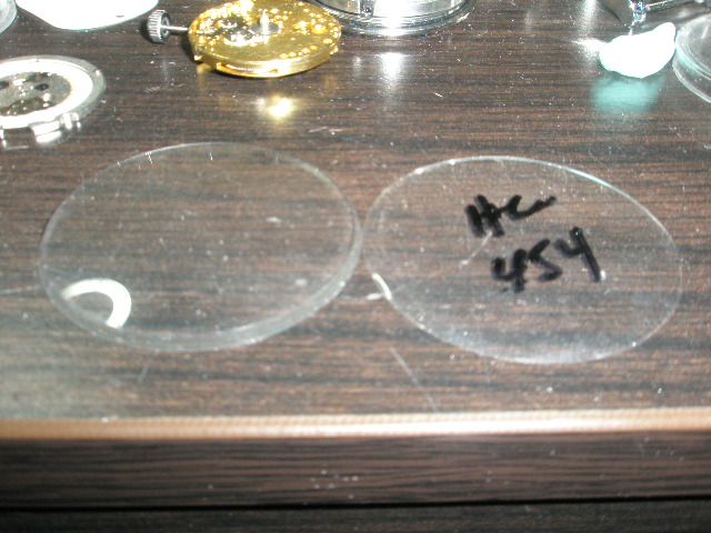

Is there a way to identify a watch crystal as to fitting a open face or hunter.Is there a marking on the label that identifies which type of watch.
May 03, 2015, 20:07
Peter Kaszubski
open face is thicker glass hunter is thin and almost flat
left side open face right side hunter glass
May 03, 2015, 20:07
Mario, generally the Open Face watches have a crystal 1.5-3.0 mm thick. Hunter Crystals are usually 0.25-0.75 mm thick and NEVER over 1.0 mm.

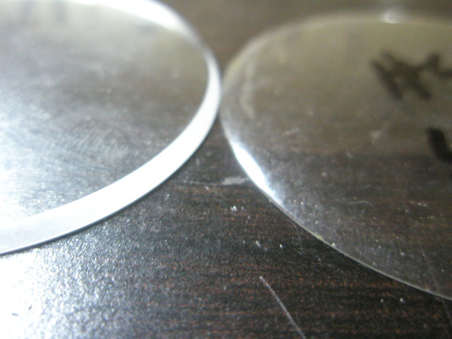

better view same size on both crystals
hunter on right side
