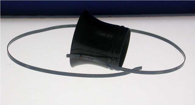

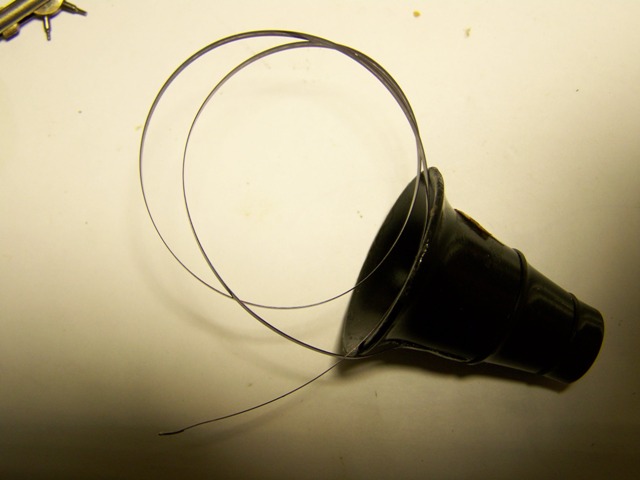

If you're wanting a cheap, but still good alternative, this is a trick my dad has used for years. Take a manifyer you like the magnification on and literally glue an old, broken mainspring to it. Make sure to use a strong spring, typically, an 18s. Like I said, a broken mainspring works fine for this if it is long engouh.
December 14, 2011, 22:32
Jared BrinkerThe spring ends up just wrapping around your head and holding it in place. and walla! hands free magnifyer for little or nothing.
December 14, 2011, 22:36

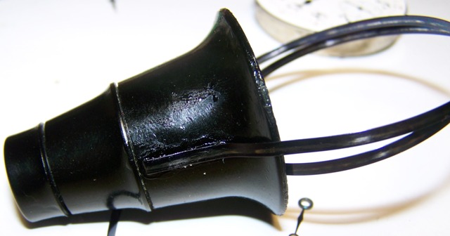

Jared BrinkerHere is a shot of the spring where it is glued to the magnifying lense. and if it breaks, glue another one on!
December 16, 2011, 18:12
Larry BuchanI use the same set up as Jared, only on mine instead of gluing it I drilled a hole through the spring and the loupe and riveted it with a copper dial foot.
