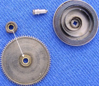

The same 12Size Waltham, and it appears that the mainspring catch is broken off of the mainwheel. Does anyone know if they are one piece, or is it just not assembled correctly? Just do not like to see a watch that is not working.

This watch looks like it has already suffered some practice and abuse, but may prove to be good watch to learn on. The grade 210 is a 7-jewel model, but it looks as if someone has attempted to up-jewel it. (By the way, a replaceable non-jeweled bearing would be a bushing). The third wheel bearing could be bushed or jeweled at this point, depending on your preference.
The mainwheel (the geared part of the mainspring assembly) has been broken -- the hub, although removable, is not supposed to come off like this. The replacement part (mainwheel with hub) is #8096.
