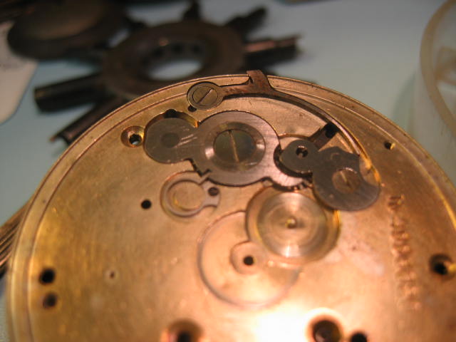

Michael, Buster's reply says it all for lubing (and cleaning) the sleeve/stem. If the stem still resists pulling and setting, then it is the wind/set mechanism on the dial plate.
I have found 80% of the "Sticky Stem" watches I have rehabilitated have an overly dirty ("Sticky") Wind-Set mechanism on the dial plate under the dial. This also (usually) means the watch should be cleaned, lubed and timed. Elgin 18s Pendant set mechanism shown below, they are all near the same looking mechanisms.
