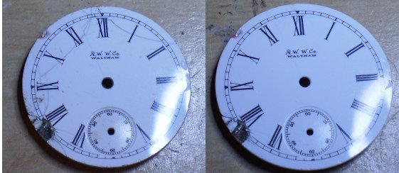

David AbbeThis is after 36 Hours soak of the three "test Dials. There is considerable improvement of the more serious cracks. At this point I plan to use this process for Cracked and dirty dials, and I will continue to use the Tile cleaner for really crudded up dials first before dealing with the cracks in Polident. A great dial cleaning method and VERY PASSIVE!

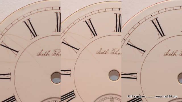

Phillip SanchezLeft Before
Center 3 minute denture cleaner
Right Comet Bathroom Cleaner
