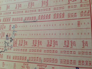

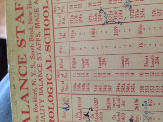

Gary E. CochranA list of Elgin staffs in a Waltham school assortment..
