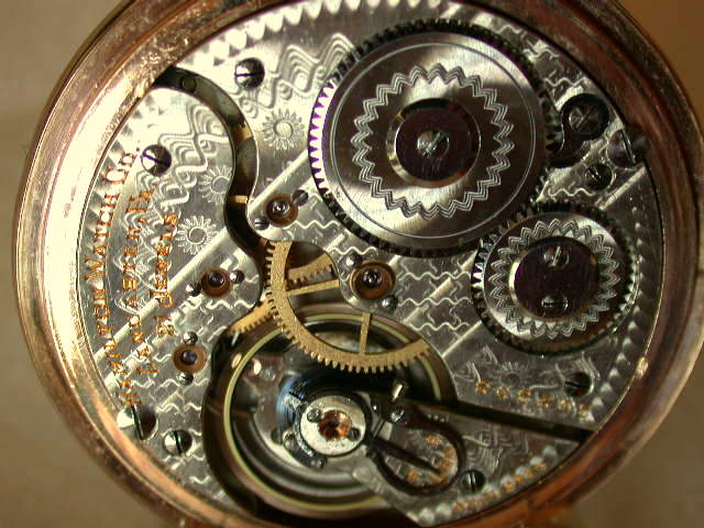

I have a 992 s/n 302358 that needs a center wheel.
Would one from a 992B fit?
Roger

hello roger,
No a center wheel in a 992b is different from the 992 model..they don't interchange

Roger - Paul is right they do not interchange.
I have at least one spare center wheel and cannon pinion for a 992. Let me know if you need one... Some of them are with a brass finish and some plated gold. The early ones have the brass finish

Thanks Paul and Jon for the info. Perhaps I don't
need one this movement is from 1903 2nd. run of the
992's so it is a early one. All of the other 992's
that I have (11 pcs.) have the gold wheel. So I thought all should have them. I do have one from
1906 that has the gold wheel. Thanks guys!

No problem roger, if you'd like to fix the 992, its suppose to have a brass center wheel and you can interchange the one from a 974 to make it easier to find one...
