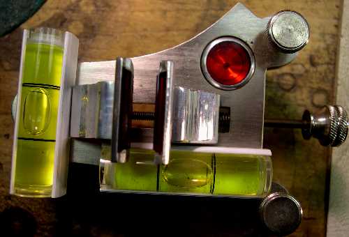

Here's a tip for the poising tool. You can get these little levels for a buck or less and it's a lots quicker to get your poising tool level using these. And then there are a lot of poising tools that don't have the handy leveling bubbly.
