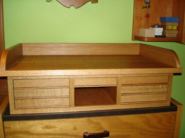

Lorne WasylishenI am kind of pleased with myself, just waiting on some brass knobs from Lee Valley.
April 19, 2015, 16:09
Lorne WasylishenSome dividers that have been sitting in my shop for years. I should have made one of the drawers double deep, next time.
April 19, 2015, 16:11
Lorne WasylishenThis centre slide out is pretty well useless but it made the whole thing look better and was fun to make.
April 19, 2015, 16:14
Lorne WasylishenThe grain on the top is beautiful but the camera doesn't capture the 3D effect, it's like you are looking down on a mountain range.
Sadly it will be covered with that no bounce white stuff.

Lorne WasylishenYes it is pretty well all oak and all scrounged from various places. Not like I'm trying to save the earth I just like re-using old wood
Top is plywood, drawer fronts and trim are old table legs I found at the dump long age. I cut them to take advantage of the quarter sawn grain.
I had one little freak out.
When I was cutting the saw kerf for the drawer bottoms I made mistake and cut the front rather than the inside. I then cut them all and glued in that little strip of mahogany, it actually worked out quite well.
