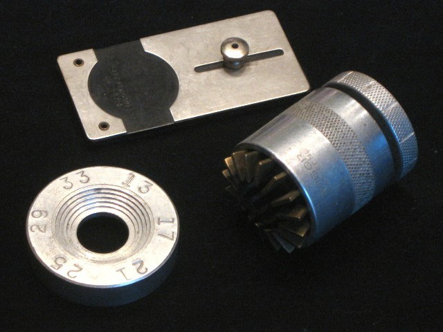

What tools will I need in order to replace glass pocket watch crystals(OF and hunter)...I mainly deal in size O, 12 and 16 size pocket watches....I found this on ebay:
Vintage Vigor Crystal Remover w/ Holding Die & Swiss Inserter Plate - Watch Tool
I didn't know if this is the correct size tool....Also any recommendations as to brand tool and additional items needed....Thank you, Robert

Robert, the tool shown is for replacing plastic wristwatch crystals. It squeezes the crystal diameter so it can be inserted/removed.
You really don't need anything for glass crystals. Just push it out and snap the new one in carefully. If it is loose you may need some crystal cement to keep it from turning. You will need to clean the bezel rim of the old glue if there was any.

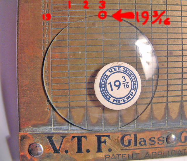

Either use a crystal gauge or a digital caliper.
Crystal Gauge in Use

Thanks to everyone who has replied....I see what Ed has but I don't have a crystal to measure by I just have the cover....If I measure with a caliper gauge the inner diameter of the void then do you use the inches or millimeter exact measurement and add or subtract a set amount(maybe a trick that helps)?....Is there a book or article for doing this on the IHC185 site(I can't find one) or a book I can get?.....Thanks in advance.... Smile

Edward L. Parsons, Jr.
Robert,
I did a quick search on fitting glass crystals, here are the results:
https://ihc185.infopop.cc/eve/f...tting+glass+crystals
William White isn't making crystals right now, but there's still a lot of relevant info.

The crystal tool you have found is for plastic crystals as has already been mentioned, for glass crystals a lot of people will use crystal cement. I personally do not like this idea as it does over a period of time cause case discoloration problems, especially on silveroid type cases. I use a bezel heater, heat the bezel up and then fit the crystal, as the bezel cools the crystal becomes tighter. In doing this you must be carefull in your crystal size selection, as it only has to be .05mm to .1mm larger than the opening of the bezel. This opening is best measured with a digital vernier caliper. For fitting of plastic crystals the selection of .5mm larger diameter crystal then the bezel opening is used, hence no need for cement once again. Please be aware that if you have a thin sectioned bezel use only .2mm to .3mm larger, otherwise distortion of the bezel its' self can occur. All the information above is from my own experience, others could have different methods that work just as well.
