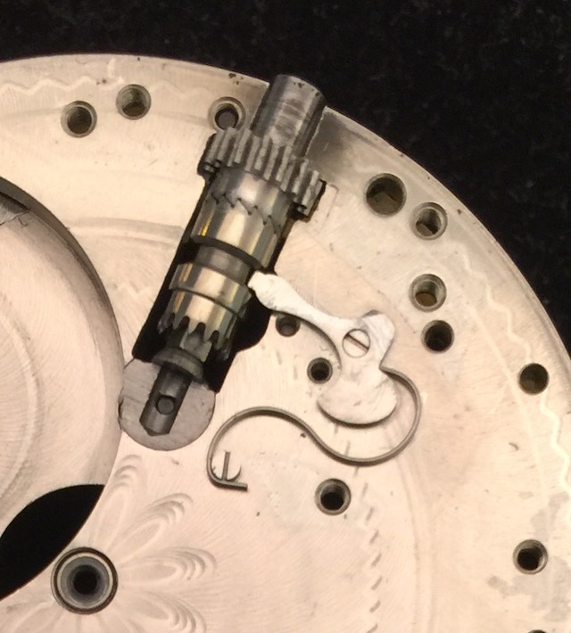

I am unable to set the time on my Waltham Vanguard
I have discovered that the Shipper is missing a stud for the setting lever to operate the clutch.
Photo shows a pin in the hole, no screw thread.
Much confusion!! Can anyone help?

Can you add a few photos of where it sits in plate etc, and more details,
June 27, 2017, 11:54
Rob CarterHey Chris and Steve here is a 16 size 23J Vanguard on my bench today so I took a picture which should be similar to what we are discussing.
Rob
www.pocketwatchrepairs.netJune 27, 2017, 12:11
Rob CarterChris and Steve here is lever.
Rob
www.pocketwatchrepairs.netJune 27, 2017, 13:35
Chris AbellThanks Rob,
picture worth a thousand words
Steve just make a new pin and rivet it in should be good to go.

Steve CowleyThank you all for your help.
I will turn up new pin.
