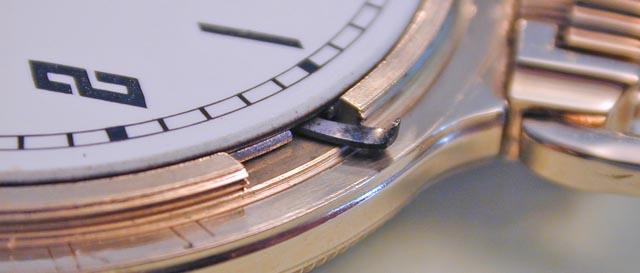

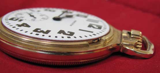

Here is a side view of a movement in my case...February 21, 2010, 15:25

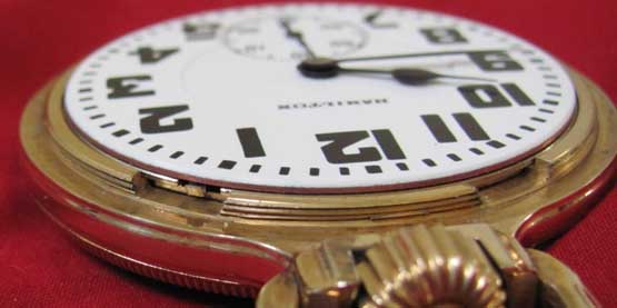

Close-up showing the lever area relationship...February 21, 2010, 18:56

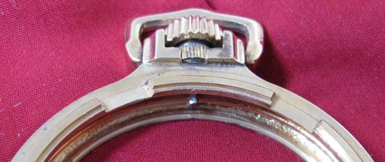

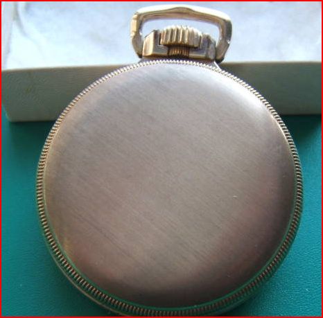

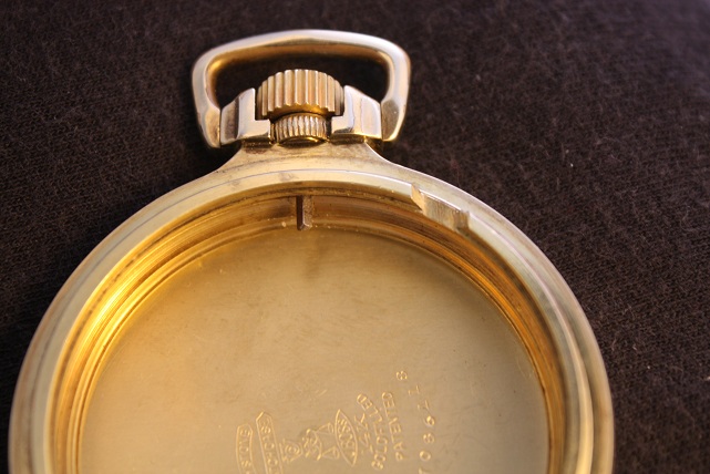

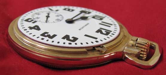

John BealeHi again. I got my watch case back from the jeweler and took 4 pictures that are posted below. I tried to take pictures of the inside of the front to show the little shelf that I think is supposed to be machined flush with the center frame. Please look them over and let me know what you think. If you agree it needs to be cut deeper then I would appreciate it if anybody could refer me to a repairman with the tools and machinery to do this work. Thanks, John
February 27, 2010, 14:20
John BealeAnother shot
February 27, 2010, 14:21
John BealeYet another shot...
John BealeLast one ...

Would it be possible to show a photo of the movement in the case from the back? Does it sit correctly in the back?
February 27, 2010, 20:41
Roger J. NolfeCan you show pictures of the bezel on the watch showing the problem? If the bezel screws down flush without the movement in it, then the bezel must be coming in contact with the dial. Are you sure the bezel belongs to that case? Usually there are numbers on all three parts that should match. It certainly looks from your pictures that the movement is sitting properly in the case.

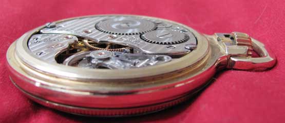

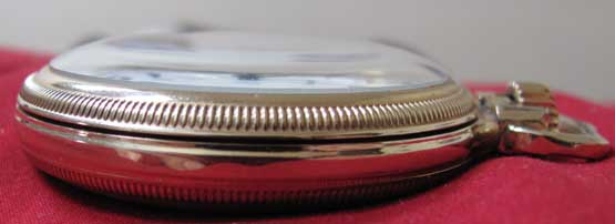

John BealeHi Guys, thanks for all the support on this. I am post three more pictures in response to Tom and Roger's post. The movement is unobstructed from slipping through the back of the case and it is clearly not seating properly. The front bezel does indeed sit perfectly flush with the center frame without a movement in it. WIth the movement it hits the dial. Here they come.
February 28, 2010, 10:40
John BealeMovement side shot ...
February 28, 2010, 10:41
John BealeFront bezel with movement inside ...

Chris AbellOne problem you have is the movement case screws have been replaced with oversize ones and do not sit inside the plate recess drawing the movement in to position, and dial is also thicker aftermarket but may still work. Putting the correct case screws in or turning down the heads to size may answer a lot of the problems

Richard RomeroJohn,
It looks like there's two problems here. First that case may have been made for a different movement. If you notice there is another set of screw marks from a previous movement. Look at how high the step is where the movement rests. On the case that Lindell shows the movement rests almost flush with the lever cut out and the case surface that the bezel tightens to. I confirmed this on a case that I have. Second it looks like your dial isn't quite seated all the way flush with the movement like it's outside diameter is too big and or ,like Chris noticed, it's too thick. There is a big gap betwwen the lever and the back of the dial. If you can't get your case to work I have a Keystone case that's this style in very nice condition that I don't need. I know your movement will fit properly in it. If you're interested send me an E-mail.

John BealeRichard, thanks for looking this over good and hard. I have tried everybody's suggestions. I have tried several movements (Waltham Vanguard, 992, 992B) and none of them fit. The case screws on the 992 I currently am trying are the correct diameter head and screw flush inside the holes in the back of the movement. I am glad you see the step where the movement rests too, it looks to be way too high. If this were lower I think everything would fit. Can't help but feel like this is a manufacturing defect. I am throwing my hands up in the air on this one and sending the case and a 992 movement to Lindell who has diligently and patiently tried to walk me through this over the phone. If he can make it work I will be quite impressed. Expect to see a post from Lindell in about 1-2 weeks after he works his magic with it. John

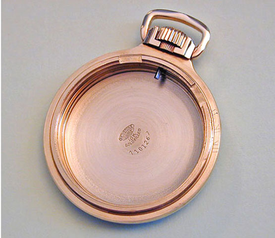

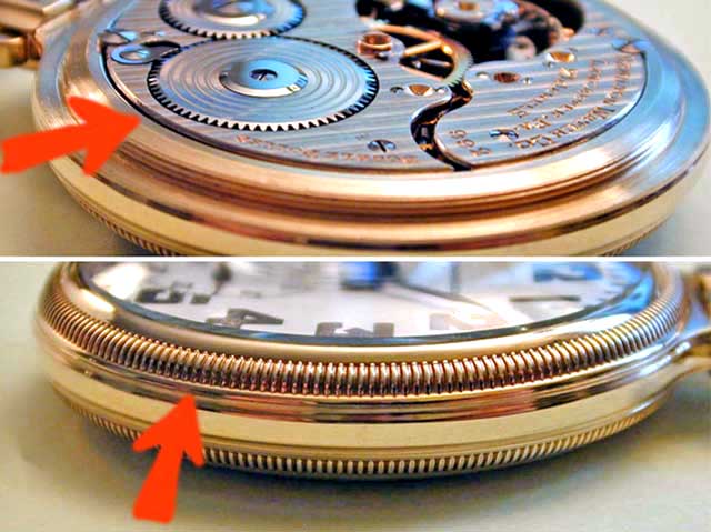

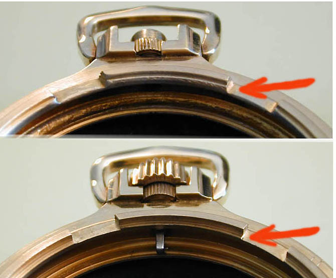

Well, we have all been speculating but now
we can make a proper comparison.
In the upper image below we see John's case, in the lower image an essentially identical model from my collection.
Follow the arrows and look all across this ledge where the movement rests you will see John's is not finished to the proper depth, it also appears to lack finishing touches inside as well. Hopefully a friend of mine who lives nearby and is doing some other case repairs for me will be able to make the needed cuts for us in his lathe. I had him take both John's case and mine so as to use mine as a template to make the needed corrections on John's case.
Wish us luck!
John's case, upper image appears to lack final finishing...March 11, 2010, 09:47
Roger J. NolfeWell that looks pretty definitive. It looks like it should be a fairly easy matter of placing the case it a lathe and trimming it down.

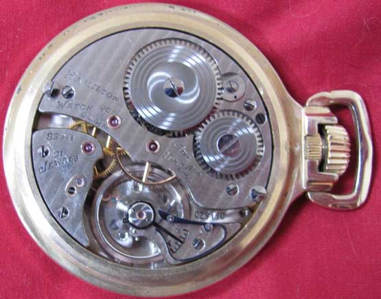

Hope things have improved
at Roger's house!
I think everyone will agree John's case has improved dramatically.
In the top image below you will see the 992 movement now extends through the frame as it should. Compare that to John's second February 28th image above in this topic to see the very big difference. Then in the lower image below you will see the bezel contacts the frame as it tightens, see John's third image from February 28th to see how that has changed.
Key to making necessary revisions to John's case-frame was having my essentially similar J.Boss Railroader Case available for comparison. Our friend and fellow IHC185 Member Don Mathis did a really nice job at a very reasonable price. When I installed John's movement it dropped in smoothly and functions as it should.
John's movement is now properly center-lined in the frame...March 29, 2010, 22:25
