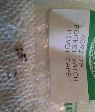

Paul J. WilliamsThe S.la rose co. (now gone ) sold roughed in pivot plugs for repair . I may have a bag of asstd. I'll let you know if I find them.
March 17, 2015, 18:40
Paul J. WilliamsWhat I have are pivot caps, these likely wont help you.

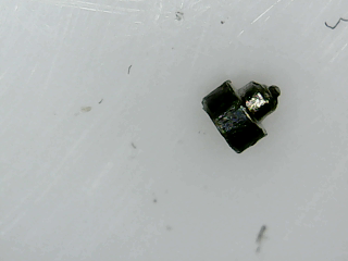

so, i found i could not measure the diameter of the broken balance pinion while still mounted in the staff. so i made a tool.
i would like to introduce the "canadian made swiss cylinder escapement broken pinion remover tool" a rather specialized tool, but when you need it you will be happy you have it!
made it from the finest sewing needle my wife had.
March 17, 2015, 20:13
Todd Verrierei got so excited i couldn't find my balance tack, so i threw that together too.
i reached inside the cylinder with my fancy new tool and pushed the broken pinion out.
March 17, 2015, 20:14
Todd Verriereworked like a charm!
here is the broken pinion!
March 17, 2015, 20:17
Todd Verriereand no damage to the pinion mount that i can see.

March 17, 2015, 20:49
Todd Verrierehi Paul,
took some work, but got it into my caliper.
the base is .80 mm

Jon HartTodd,
Have a tube marked pivot caps. These are roughly .85 mm in thickness
If you think they will work can send you a couple
Does the staff (pivot cap as a possible fix) just pop into the little basket looking "thing"?

keeping in mind that i trust Davids assessment that the odds of me getting this movement working are zero, i would love to try.
so yes, i would love to have them, but i think the bases are too long. (see mine) but i would file them down and love them and do my best to make it work.
still, i think Pauls' look more like what i need

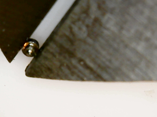

Todd Verrierethe staff looks like it was staked into the "basket looking thing" there are 3 notches along the rim of the "basket"
you can see in this pic where a staking punch has hit it

Paul J. WilliamsI'll try to measure mine soon and let you know.
Make way for a good fit, no distortion. The cylinder should be hard tempered, making it fragile.
March 18, 2015, 11:28
Paul J. WilliamsThe largest in my asst .76
March 18, 2015, 16:46
Todd Verrierehi Paul.
i believe Jon is sending me a couple of .85mm but i would like a couple of your .76mm as well. i want to cover my bases.
how much would you want for them?
