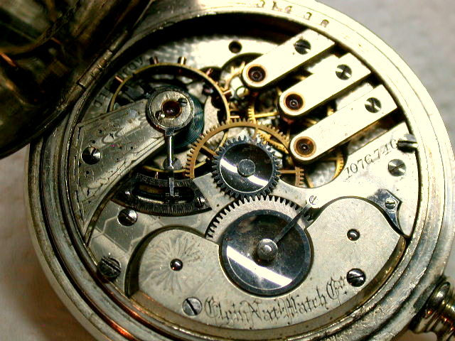

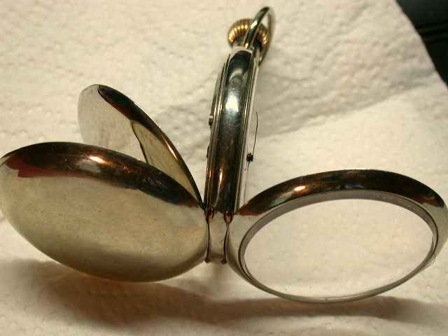

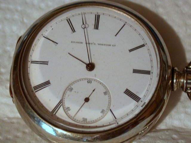

I have for a long time wanted one of these. Finally got one s/n 1076746=1882,15j,mod.2,grade 86,3 finger movement only,in the hunter mode. Need to get the movement to change to open-face. I did have a o/f case,hinged bezel and back that it fit after I changed the stem to female. It starts right up and is very accurate. Need a hour hand or full set.

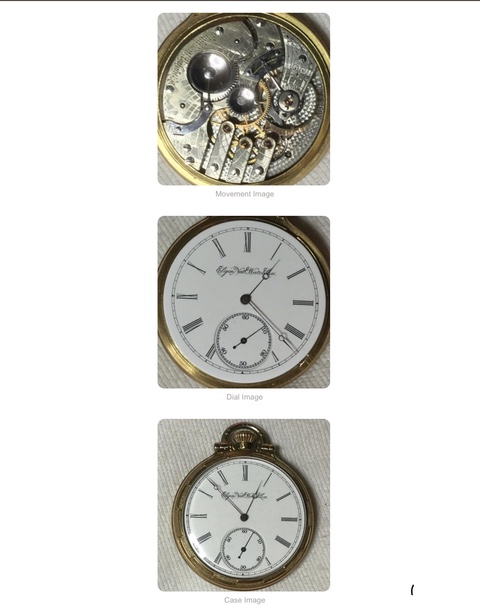

Mark ClarkNice watch Roger...
I bought one here on IHC several years ago, serial #6336006.(1896)
Excellent running watch, and a good looker.
They tend to be harder to find than you would thought.
Mark
June 24, 2018, 12:28
Mark ClarkImages from pocketwatchdatabase.com
