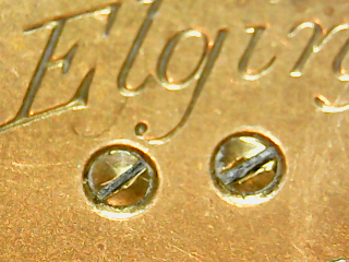

hi everyone, as most of you know i am working on an 1884 elgin full plate. i want to do some work on the top plate but am afraid i will damage the banking pins. can i unscrew them and put them back afterwards. i know this will involve adjustments upon reassembly of the movement.
pics attached

NO! There is a Looonnnng reason why they are what they are. So the shortest reason to touch or remove them is NO!

thank you David, this time i will listen as opposed to last time.
the problem is, as my wife of 30 years will attest, i am incorrigible. i really want to play with them! but, based on your reaction, "nooooo!"
i definitely won't.

David is right. They are removable but unless they are bent why would you want to? Don't even try to adjust them.

thanks guys, that is why i asked first. i have been searching past topics and couldn't find that.
