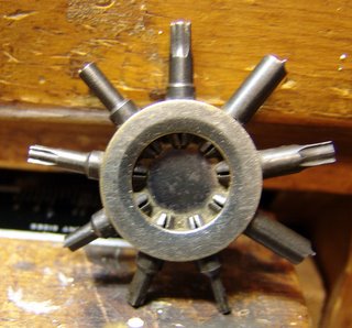

This is the one I have, each end has a fitting to fit different size & type of stem sleeves.
tool

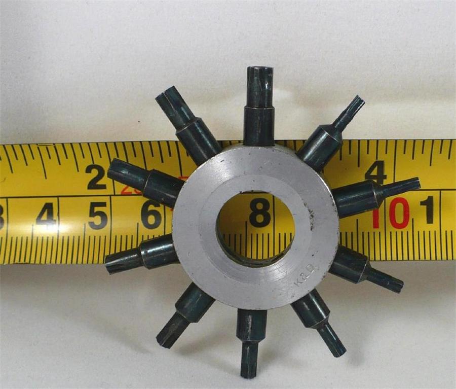

Dana, I would try using a screwdriver when I first started, then I bought my Case Stem Tool and could not believe how much simpler it is when one has the correct tool for the job.
I think I purchased the tool here on 185 but can't remember for sure, but no matter, they are not very expensive....you can get one on fleabay, search for 'Sleeve Wrench'....
The one I have looks similar to Tom's, they all look very similar anyway....I noticed on Tom's wrench that is a 9 tool, while mine has 10....
