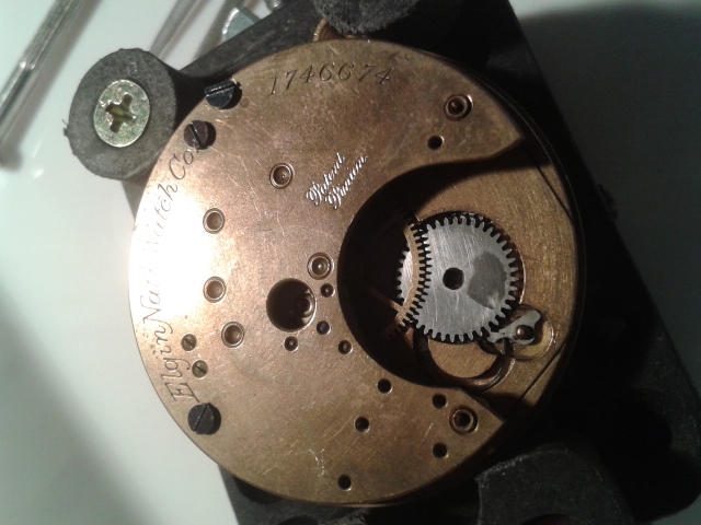

i am attempting to diassemble an 1884 elgin Gr. 96.
the balance wheel and bridge, barrel bridge, and barrel are out. this is a non-runner i purchased for practice, but i really love it and don't want to hurt it. i have researched all i can and i understand to remove the screws then flip it over and remove the pillar plate so as not to damage the pallet fork with the potence.why does this make a difference? will the pallet fork stay in place with the potence if upside down?

Todd Verrieresorry, forgot pic
this thing is filthy inside

Dave TurnerTodd, On these type watches, if you were to remove the top plate you could damage the pallet fork by dragging it out along with the top plate.
The end of the fork that connects with the balance wheel extends into that little round opening on the plate.
Actually, I remove the top plate watching carefully to relieve the end of the pallet fork.
I'm sure others here can give you a more specific detailed answer.

Serge BarlasHi Todd,
I have worked on many 18 size Elgin's and as long as you take your time and do not force the top plate up you will have no issues. The trick is to be patient and take your time!
The re-assembly of a full plate watch is another matter. I have found that the best way to put the movement back together is to work from the top plate up; basically building the watch upside down. This way the pallet fork will be in the potence when you cover it with the pillar plate. Once all of the arbors are in their jewels / holes and properly located, carefully turn the movement over and screw in the top plate.
Hope this helps! Best of luck.
