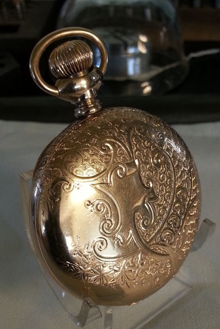

April 14, 2015, 20:51
Paul D. Trombley
Tada!
Paul D. Trombley
Movement
April 14, 2015, 20:52
Paul D. Trombley
front
Paul D. Trombley
back
Paul D. Trombley
hinge, I am particularly fond of cases that carry the art work from cover to cover across the body of the case.
