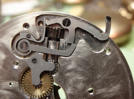

Tom BrownBuster
Here is the setting mechanism for a series 11 with the snap on dial, when you pull the lever out to set the time, it just barely catches on the upright arm on the right.

Buster BeckWell I pulled the hands and dial and at first I didn't see any problem. But then I studied and studied the picture Tom sent of a like watch in the setting position and it hit me
!! The very small end of the spring on the left edge of the set lever was bent down between the end of the lever and the winding gears! So naturally when you pulled the lever out the spring would push the lever back in
!! After removing the set lever and carefully bending the tiny spring end back up, I repositioned the set lever and viola

Tom BrownGreat Buster
I am surprised the piece didn't break off when you straightened it you were lucky. Glad you got it going again.
