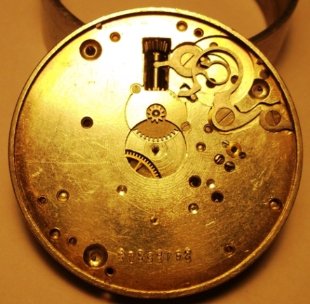

Hi Does any body have the layout for an Elgin 12s PW ( Grade 303 Model 3 circa 1929)
Don't say it I took it apart and forget the arrangement for reassemble).
Arrangement under the dial.
Thanks in advance.

Melvin SiedmanThank you sooo much I will be checking the arrangement later today.
Mel
October 21, 2015, 13:16
Melvin SiedmanThank you Douglas.
That was exactly what I needed.
Not sure what I had wrong, but your picture helped me set it all correctly.
It now sets and winds correctly!
Thanks again.
Mel
