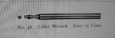

There is a special tool for rotating the hair spring collet. If you don't have one, I can shoot you a picture of one tonight.
February 11, 2014, 13:53
Peter Kaszubski
ok so the hairspring should be move not the roller table
here is my tool for hairspring
February 11, 2014, 13:58
Paul D. Trombley
There is a tool that looks like a thin hollow stake with a nib on the end. This will fit over the pivot/staff and rest flat on the hair spring collet. The nib fits in the slot in the collet allowing you to rotate/index the collet on the staff without stressing the hair spring.
If you do not have this tool, removing and reinstalling the hair spring is your next option, but risks bending the hair spring, loosening or springing open the bight of the hairspring collet...
In the same add you pulled this photo from, what you are looking for is in the next photo... it is called a collet wrench.

Paul D. Trombley
Likadis
