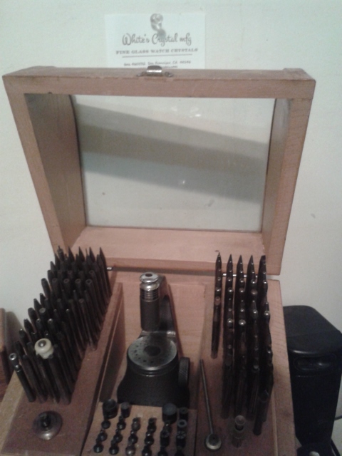

P.S. your card is pinned to the wall above my staking set.
just in case.
