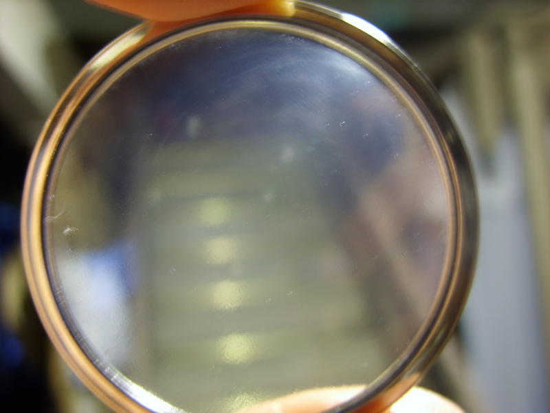

I've been trying to clean up a crystal that has an uneven cloudy type appearance,mostly on the inside.This is from a salesman's case that looks unused. Both glasses are scratch free; only one has the "stain" and the crystals were glued in.I don't think the problem is glue, but I'm not sure.
I started with cerium oxide, but gave up and went to #400 grit silicon carbide. I've been at it long enough to wonder what I'm up against-I've had scratches come out easier! If I didn't know better(?) I'd suspect the glass absorbed something...somehow.
"Search" didn't get me far, and it looks like a 30 minute job is going to take hours-unless somebody knows something that'll help...?

Marty BellEd and Scott- Yes,it's glass-and I'll try and get a pic'; like I said there's no scratches just a foggy,blotchy-type stain. I was afraid it was super glue, but acetone didn't help. Let me try for a pic- shoot-I give uP!!!!

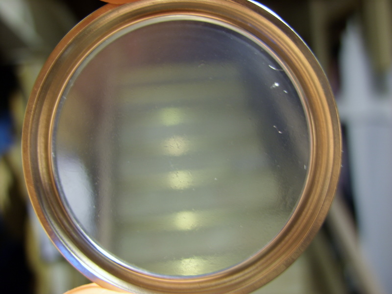

Marty BellFINALLY! I hope this'll get me some answers- those threads above from Don (thanks!) helped me for other problems but not this-anyone seen this? Remember the crystal was glued-maybe super glue-does it stain glass?

maybe easier to remove the crystal first then give it a wipe round with some nail varnish remover (acetone) if that doesn’t work soak it overnight in ammonia, if still no joy work a solution of Cerium oxide and polish back, if that don’t work drop in trash and find a new one

Marty BellChris I've done all that-I just can't believe something could be absorbed into glass-maybe I'll just get my drill and work the silicon carbide into it for a couple hours...I'll try a while longer;I'm supposed to be trying to blue hands but I got this salesman case free and unused.

Marty BellOK -Maybe most people would toss it,but I need to learn and see what can be done. So me and my rotary tool went through a few felt pads. I went back to #600 grit silicon carbide-no cerium oxide yet;maybe later.
For those interested(like me)in what could have caused this damage,here's a clue-after removing the worst of the "stain" I saw a pattern of tiny pin pricks covering the glass.These have lightened some the more I work.Very strange.
