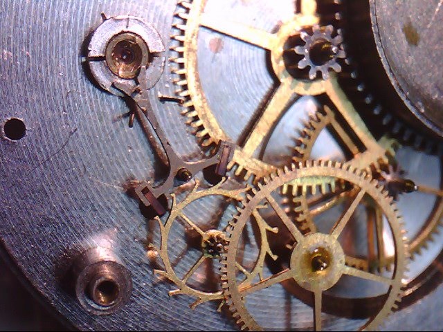

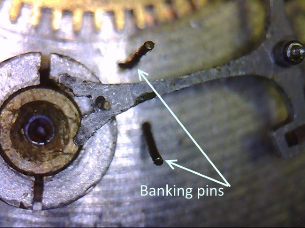

The pins are all screwed up on this unit. I have taken two photos of it. Can you tell me the spread that it supposed to be? They are bendable only and not adjustable. It refuses to tick in its present condition.

Buster BeckMy notes I have saved regarding "banking pins", taken from publications and listening to different repairmen go something like this;
I don't believe there is a set predetermined one size fits all "spread". The banking pins are there to allow proper clearance between roller jewel and fork horns, guard pin, and the safety roller.
They should be far enough apart to allow the unlocking of the pallets from the escape wheel teeth at both unlockings and to allow corner freedom of the roller jewel in the lever fork. Too close and it won't run, too far spread and the balance will lose its motion.
Once that is set, there should
not be any reason to move them again.
To adjust the "total lock", that will be done by moving the pallet stones in the slots on the pallet fork.
However you
must set the banking pins to control proper clearances of the fork/roller
before you move the pallet stones.

David E. Booth, Jr.I recall something similar from one of the talks at a Horological Association of Maryland meeting. Additionally, someone there (probably one of the guys with a lot of experience) that in watches with non-adjustable banking pins, the best place to start out is with the pins as nearly perpendicular to the plates as you can get them. He said the manufacturer usually designed them so that the holes can be drilled and the pins set and all further adjustments made at the pallets.

It almost looks as if the entry pallet is overbanking - in the photo it appears locked where it is, yet there is still tons of space between the arm and the banking pin. And the exit pallet looks really long by comparison with the entry pallet - almost as if maybe someone replaced a broken pallet with one that was too long, then tried to compensate for too much lock by opening the banking pins.
David said it well. I believe some moron of a "fly by the seat of his pants" tinkerman, has took a lazy mans approach and tried to adjust with the pins instead of at the pallets. I would try straight up/down and see how the pallets unlock and lock. Then
forget about those pins and do any other adjustments to the lock at the pallet stones themselves.
