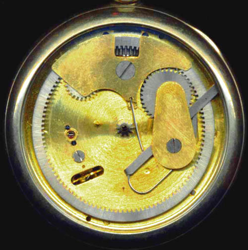

Here's a creative implementation of a lever setting mechanism. Here it is in the winding setting...

Mike MillerAnd here in the setting position...
Can anyone guess the manufacturer?

Steve MaddoxI really don't think that will be necessary.
Now, do you know in what way mine differs from yours?

Aaron BereiterOK I'll guess. Is that one of those "long wind" Waterburrys or maybe New York Standard?
I really have no idea and believe that first watch I'm refering to is a much cheeper watch but what the heck you never know right?

Mike MillerNow that's a "worm" I'd like to have

Steve MaddoxWell, as y'all can see, the worm has turned......
Hey, at least I didn't say: It's a dead-ringer for Mike's watch!

Mike MillerAnd here I thought I'd stump someone. Not a chance with this group. Steve and Aaron nailed it... an 18S New York Standard.
And it should look very familiar to Ted, since it came to me from him. I would imagine that all of these needed a two footed dial due to the movement of the gear-ring. Now to find a two footed dial.
Mine doesn't have the worm gear, but still is interesting to me. Thanks for playing the game

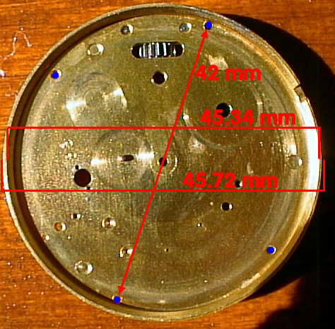

Mike MillerBrian,
The dial feet on my watch are around 42mm. so it would seem to indicate that this isn't the correct dial.
Steve, the yolk does have the cutout to allow for dial feet to utilize two of the 4 holes that are on the pillar plate.
Here's a picture of the pertinant measurements. The other two dial feet wouldn't be usable due to the movement of the gear-ring. It looks thile this pillar plate arrangement is identical to yours.

Mike MillerNow as to the pinned dial...
There are no dial screws, and the two usable dial foot holes on the pillar plate seem to have marks indicating that at one time, a pinned dial was used. The SN of this movement is 36785. The mystery continues....
BTW I do have a NYS dial that has had the dialfeet removed that can be used with dial-dots, but to do it right would be better.

Mike -- The images of your pillar plate above really DO look like it once had a pinned dial, but the holes which may appear to be dial foot holes, may actually have been "alignment" holes for holding the plates in position while the various machine processes were performed. It's possible that two of the holes may have performed a dual purpose, but it's likely that the other two were only for production purposes, and were never intended to hold dial feet.

Ted SteuernagelMike & Steve, Mike is right on the pinned dail when i got that watch it needed a complete balance so i came across a parts movement the balance was the only thing good#38606 serial. So at work today this was driving me nuts. Came back home made a dash to the drawer still no feet (but) came up with a dail porcelain roman numeral not sign has the dail legs at 3 1/2 and 33. It has a hairline from center to 12 plus a chip at 1. Mike today was a holiday no mail will reopen the fun box and put this dail in hope this help. Learned some great from all this. Thanks Steve

Mike MillerWay to go Ted!
It pays to never throw anything away! The NYS is now running and keeping great time. It even has it's original NYS Case, so this baby will be all original real soon.

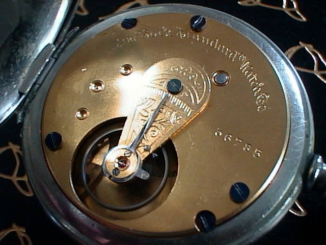

Mike MillerI just wanted to thank everyone for contributing to this thread. As far as I know, there's not a lot of info that has been put together on watches from this company.
Anyway, thought I'd add a couple of pictures of the finished product. Thanks to Ted for forwarding the dial. It needs a little restoration, but looks quite at home on the model 2. The watch is now running well and keeping great time.

Mike MillerWe've seen the pillar plate side... Now the rest of the movement. Very simple. One might consider it a very early "dollar watch."

Steve MaddoxMike,
I have a NYS case for mine too, but I think it's later vintage than the movement. My case is gold filled, with a threaded back and bezel, and I think all the originals for the "worm" models were probably like yours, nickel with hinged backs and bezels. (In fact, it's entirely possible that the case I have may be more appropriate for your watch, and vice versa.)
By the way, if you like, I can (eventually) find a more correct (fine spade) hour and minute hand set for your watch. I'm not sure about the hour hand you're using, but the minute hand looks a lot like one from an 18s Elgin RR model from the 1910s.
The seconds hand, however, does look right.
