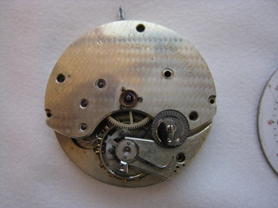

A friend of mine asked me to look at a pocket watch to see if it can be put back in running order. It has a private label on the dial, "A. Stowell & Company". It has the same label on the watch movement. It needs a new main spring. It has a "T" end on it and is 2.65mm wide. Does anyone know where I would begin to look for a replacement main spring for it? It also could use a new dial face.

Can you post a picture of the movement?
Then, I can find the correct length spring to go with your 2.65mm
August 01, 2013, 23:41
John P. StollOk, we'll see if I can post these images. The serial number's kind of hard to read, 81290.

Jon HartOk - John...
T-End and 2.65mm
Lets see what we can find for ya

Jon HartThinking maybe a South Bend 4374 for a 1st Model might do the trick... And I do have one...
16sz
T - End
2.60 - 18 Strength
20.25 inches length
