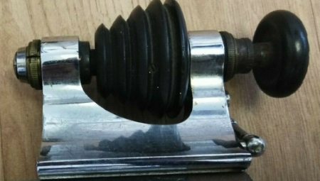

Dave TurnerCan you post a picture of it?
Dave Turner
September 08, 2019, 08:45
Serge BarlasHi Dave,
Attached is a pic of the head-stock setup. you can see the collet in the front end and the draw spindle at the rear. I have tried holding the spindle with a pair of vice grips and rotating the draw bar knob. The only thing that happens is that the knob turns in place.

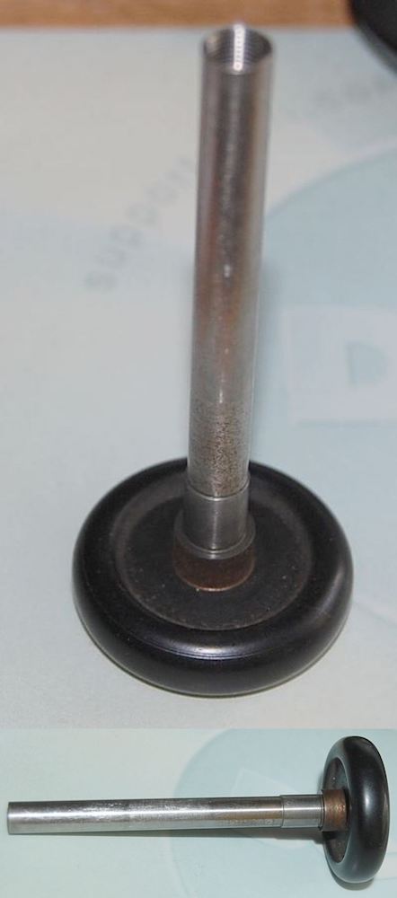

Dave TurnerYea, mine is the same. Looks like it should not spin and was made at the factory as one assembled unit.

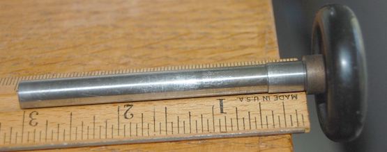

Dave TurnerHere's a measurement on mine. The ruler on the right side is sitting at the end of where the drawbar pulls up tight to the spindle. There is no gap between the brass sleeve that the black handle fits in and the end of the spindle.
Dave Turner
September 12, 2019, 13:53
This picture is very helpful. What I have is a bit different... the knob on mine is up against the spindle, I don't have the spacer or stop as is show on your draw bar. That's what makes me think it is the wrong part.

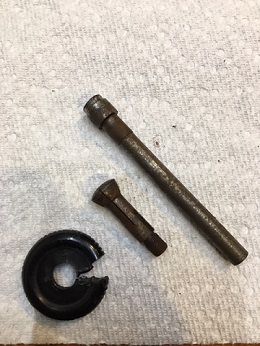

Finally success!
It took cutting the wheel off of the draw bar shaft, as it was turning in place, which allowed me to grab the shaft with a pair of vice grips. This thing was so rusted in place that it still took several light hammer blows to remove the collet. And now to the clean up and lube phase of the project...
