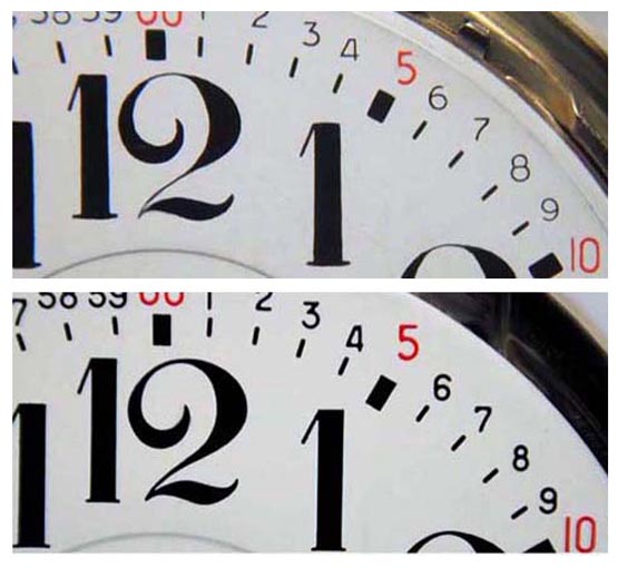

The fact your dial has the partial 7 and 5 hour markers along with the marginal minutes it is either an original melamine or one of the S. LaRose type replacement dials. As you found in that linked information there is a difference. Examine it very, very carefully and compare the outer-track numerals to the images and what you read in the linked topic you'll be able to determine which you have. To simplify matters I have merged the two images and posted that below for comparison.
Dial on top is melamine, lower one LaRose replacement...August 18, 2005, 23:20

I second the comments above. You've made me an overnight expert! Based on the location of the red numerals, the curve of the 7 minute numeral, and the overall brightness of the dial, I have to conclude that I have the LaRose reproduction.
You were also correct that the gold rim around the sub-seconds dial is wear. A close look under a couple of magnifiers shows that the white surface of the dial is partially worn away, showing darker material beneath.
I suppose my next decision is whether to stick with the very nice repro or look around for an authentic (but possibly less attractive) melamine dial. Either way, I very much appreciate your help. I look forward to learning more.

Anyhow, in looking at all of Lin's images of the Melamine and LaRose dials, I now see subtle differences in nearly every minute numeral. In addition to the hook on 7, there are noticible differences in the upper portions of 2 and 9, and the lower portons of 3 and 6. Also, the "O" in HAMILTON is oval on the Melamine dial and more rounded on the LaRose. It's all pretty arcane stuff, but it now appears that I do have a Melamine dial that is presumably original.
This is great news for me since it's a nice looking dial without the cracks and divots mentioned in the post above. Given Tref's comments, I'll treat it with respect!

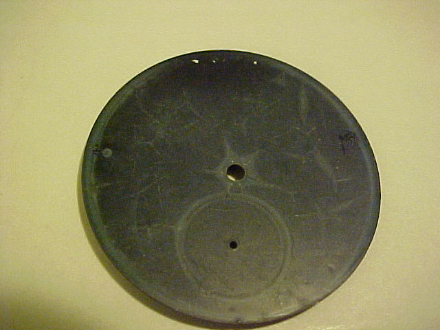

One day that Melamine dial might look like this:
August 20, 2005, 19:17
Peter S. BalkanGosh! You don't often see them without hairlines!
August 20, 2005, 21:05
Terry HillBut you can see where they
were
