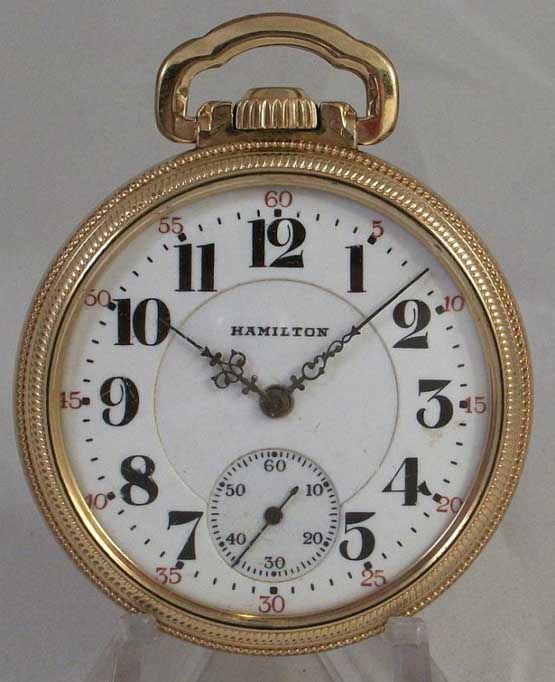

Skip GlascockCan these hands and case ready go with a Hamilton 992
I would like to bid on this watch if it is a real Hamilton 992 case and hands.
Any help would be great.
Thanks in advance.

Joseph PierzynskiHi Skip, I can tell you for sure those hands are definately NOT correct. And most likely the case is not correct either. Enjoy

Skip GlascockThanks Joe, I also thought neither were correct.

Stuart,
Through 1929 the Hamilton 992 was available to retailers as a movement only, the number would help to narrow that down. Check it here...
https://ihc185.infopop.cc/eve/f...254108073/m/21410695
If the movement in question is prior to 1930 and in the absence of other case-screw marks that could conceivably be the original case. But as Joseph pointed out those hands, although nice for a Hunter-Cased movement or a lesser grade, would not be original to a 992 as they originally came with, shall we say. more sensible hands.
