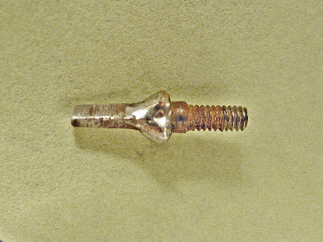

The case James referenced above where the bezel and back numbers do not match the frame is a Wadsworth-Hamilton Case Model 8 and the broken stem is on "The Illinois Watch Case 181" example. I measured the "181" Stem at just slightly under 10 millimeters and a picture is posted below this message.
James formed an erroneous belief that since we told him that Hamilton bought Illinois they might have sold Illinois movements during the 1928-29 time-frame in Hamilton-marked cases. In fact they did not, but the good news is that his Type III-B Bunn Special dates to 1929 and so does his marked-as "Illinois Watch 181" case.
James needs a 10mm overall length stem like this one to fit his 181 case...

I tried the fit with a 992B Case stem. The seller did not know the case maker, the stem was in a drawer marked 992B.
A total fail, the threads do not match. The stem at the widest spot passes straight through the bushed hole in the Fahys 181 Bunn Special Case.
Back to square one!
