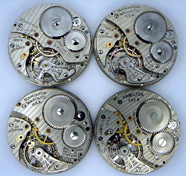

Very much for real Lenny,
The highly polished gold center wheels are found up to something above the C100000 area. Terry Hall and others are charting the numbers and may have more precise references on that. In the image below you'll see the four "signatures" on civilian 992B watches. Fred Hougham put together that image which helped lead us toward establishing this research forum. In Fred's image you'll see the first two, C30898 and C65532 have a highly polished gold center wheel.
The four 992B signatures are an important reference for collectors...
