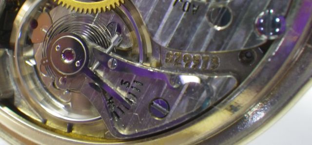

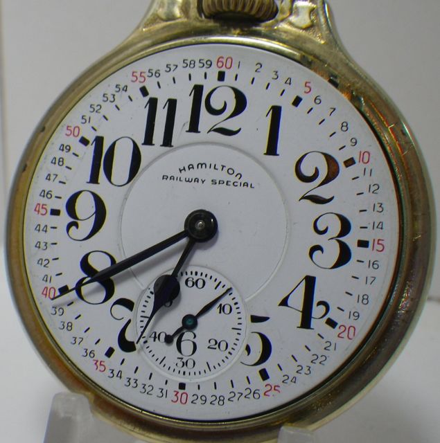

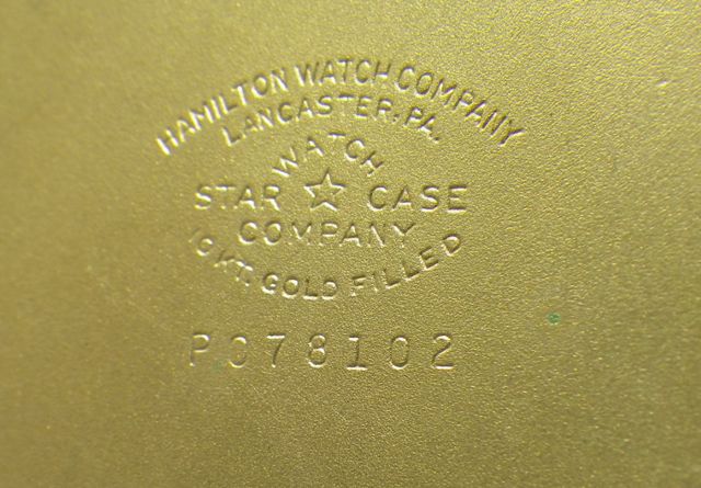

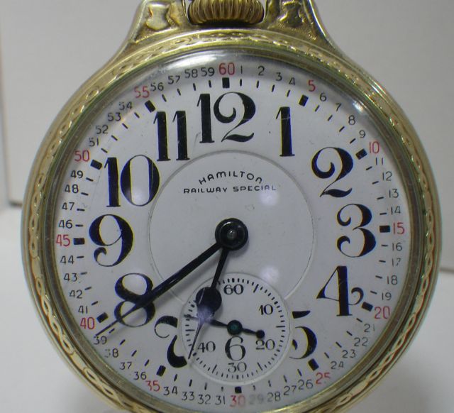

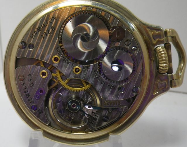

I Bought this watch today. It is marked S29573 992B Hamilton.

Krister OlssonGene, this watch is a put-together of left-overs. If Hamilton did it or someone else did it, I can't tell. Every part is in roughly the same time period, the case #17, the sig #4 barrel plate and the 950B pillar plate. My gut feeling about this is that it is a tad early for it being a factory job. A search on the serial # comes back with this:
Grade: 950B
Movement Serial Number: S29573
Estimated Production Year: 1963
Run Quantity: 2000
Jewels: 23j
Movement Finish: Nickel
Model: 6
Movement Setting: Lever
Plate: Unknown Plate
Adjusted: Yes
Adjusted to Positions: 6
Railroad Grade: Yes
Regards, Krister.
January 20, 2013, 19:44
Eugene BuffardHello Krister here is a link to
HAMILTON "4C PREFIX" AND "S PREFIX" 992B POST-PRODUCTION DATABASES with the S prefix 992B and my watch movement number S29573 is 17 Numbers from the lower number and 51 Numbers from the next higher. It is the real deal.
Who would destroy a 950B to make a 992B. if it was S29400 or so then I would think on the same lines.
January 21, 2013, 04:14
Krister OlssonGene, I'm sure glad that this turned out to be the real thing! The reason for my gut feeling was that the 950B's major production took place in 1965 which would make it unlikely for a 1963 pillar plate to be left over. However, it taught me a lesson too. Don't spill your beans before a thorough investigation is conducted. Many thanks to you and Lindell for clarifying this.

Eugene BuffardActually serial # S29403 is a 950B that was made in 1965 Which would put mine made after 1965 normal production.
Where did you come up with mine being a 1963 production.
I could not find any production # dates for this watch so I went to Lindel to ask what he thought of this watch.
Until 2 days ago I never even new about S Prefix 992B.

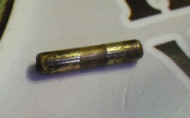

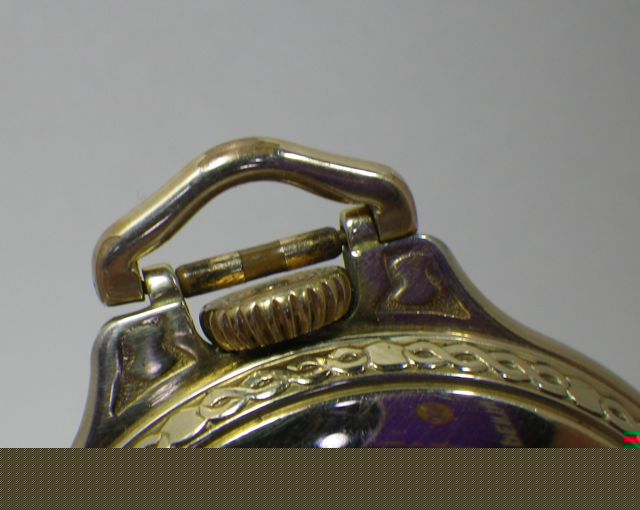

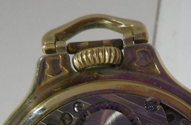

Eugene BuffardLarry here is a couple photos that shows the bad bar over crown.
January 26, 2013, 23:00
Eugene BuffardHere is another shot. It looks terrible.

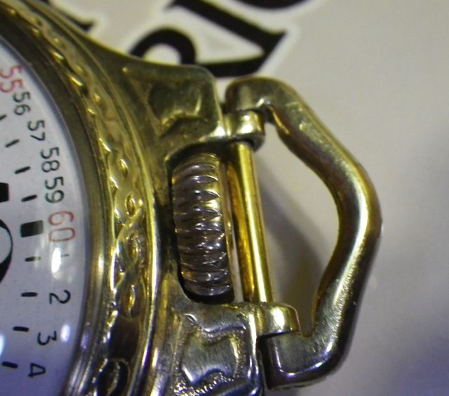

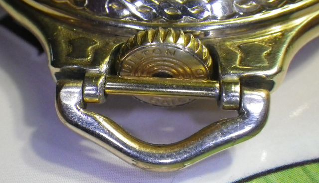

Eugene BuffardThe finish product using the rolex spring bars that Larry suggested to fix my Bar over crown.
January 26, 2013, 23:05
Eugene BuffardShould I try again Larry.
January 26, 2013, 23:59
Jon HartLooks like your bow needs to be replaced, too...
January 27, 2013, 08:50
Edward KitnerNice fix Eugene, that is what we do around here
January 27, 2013, 09:35
Eugene BuffardJon the bow has brass on the underside. Only
January 27, 2013, 21:12
Larry LamphierNice job my friend!!!
Don't throw that bar away. You did such great job that I hate to tell you this, but I really think you could have fixed the original.
That is a really good fit though Gene!!
