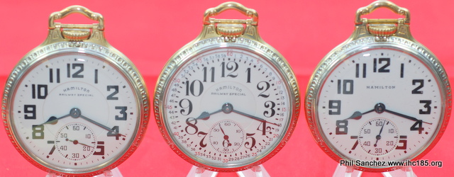

Richard RomeroTom,
Correct dials for the 992B Number 3 Tu-Tone case are the 536, 537, and 080 as well as the 081. A couple of years ago Phil posted a picture of all three dials that are illustrated in a Hamilton advertisement for the No.3:
I have these three tu-tone 992B watches. That SS 081 dial is a great fit for the No. 3 case that was less expensive than the Model 10 and 11 gold filled cases available at the time. For the watch to be correct just change the baton seconds hand to a dart style.
RR
Dial Numbers: 536 - 537 - 080; Photo courtesy of Phil Sanchez

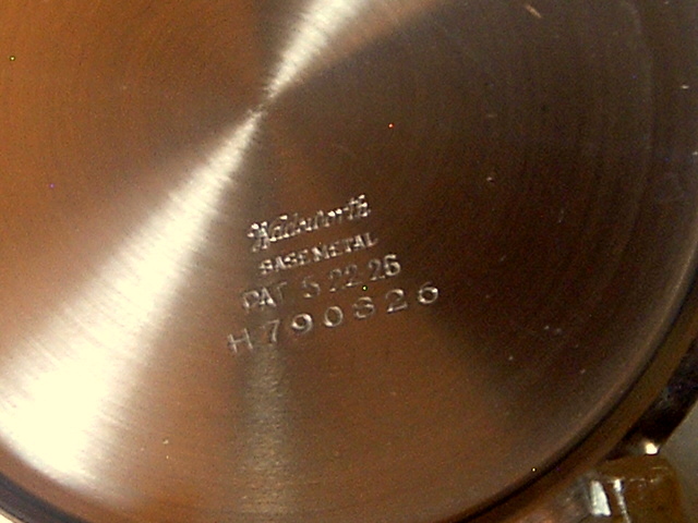

Roger StephensJust received 992B S/N C167410=1946 in #3 TWO-TONE
Wadsworth case H790826 Base metal
May 23, 2015, 15:25
Roger StephensCase back

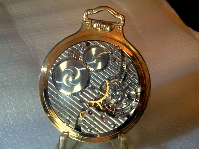

Roger StephensMovement C167410

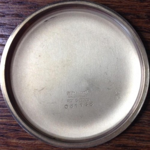

Michael P. McNameeRichard and all,
I have a 992E with movement serial # 2606468. It is in what looks to me like a legit Model 10 case, EXCEPT that the case back shows a 6-digit serial number, 081148. Our Wadsworth Hamilton data base says that a Hamilton case from this era should have a 7-digit case serial #. If another digit were tacked onto the end of my case number--e.g. 0811480--it would appear to be right in the ballpark for the ca. 1936 movement. The case has the standard lever cutout and is stamped "Hamilton Railway" on the top of the crown.
Anyone have any thoughts about this apparent anomaly? There is no evidence that the case number was mis-stamped or that an additional digit was too-softly struck. Was anyone reproducing these cases at any point, and if so could this be one of them?
I'd also note that the watch has the neat "arrows-out" Hammy dial that I understand was made only ca. 1936.
All thoughts appreciated.

Michael P. McNameeFront of Model 10 Case:

Buster BeckThe Wadsworth 16sz cases that Hamilton used in 1924 with 7 number digits began with #6900000 on their "cross-bar" cases. By 1925 the numbering system started with 0100000, again 7 digits. That series continued until 1936 when the last 7 number digit was presumably 0999999. In mid 1936 the Wadsworth Model 10 cases came out and production of them continued until 1946-47. In our discussion it will be
important to note that the patent date stamp,
PAT 5-22-26 was discontinued in 1946, thereby we know this case was made prior to that date.
By 1937 Wadsworth had used up its 7 number system so they started using the letter "H" in place of the first digit but now they would use only 6 numbers following the letter. The H-Prefix thus began at H000001.
I am saying all of this to be able to portray that Wadsworth always used a 7 digit number or letter/number combination on their 16 size watch cases.
Since this 992E was made in 1935-1936-1937 by using John Gelson's list on IHC185, we know that a matching era correct case would have to of been made from about 1934 to 1937. With that in mind we can deduce
that
if this case is in fact the original case that this watch left the factory in, then it seems that the
last numbered digit in the 7 digit serial number is indeed missing.
This is about the only plausible answer to this dilemma that is upon us
These things

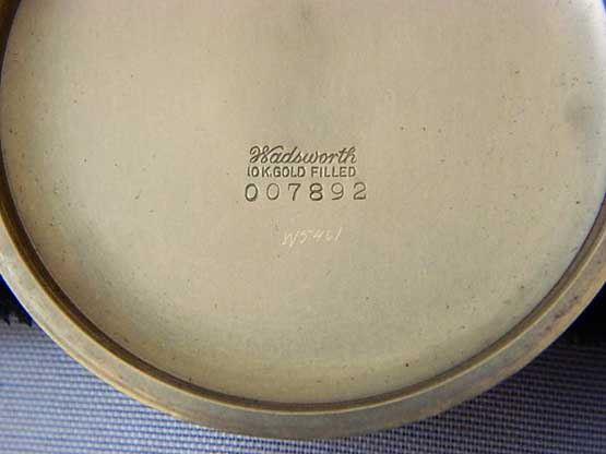

did happen from time to time. We know that by researching our own IHC185 history and watches that can be proven. As for instance I invite you to take a closer look at the late Ed Parson's thread "992B Examples in Brown Boxes" on page 4 and Set 28.
https://ihc185.infopop.cc/eve/f...073/m/7601094112/p/4 This is the first time anyone has caught this since Ed posted it almost 4 years ago, and even sharp eyed Ed himself overlooked it
By looking at this boxed example of 992B # C-216185 from 1948 you will see that Ed listed it as Case 2 #0007892. And sure enough when we look at the box label we do find that the Hamilton Watch Co. boxed, packaged, inventoried, sold, and shipped this watch to the buyer with that case number on the box
Now scroll down and look at the actual case number on Ed's watch. What
Why sure enough and never caught before by Hamilton, and all those years and Ed himself, Wadsworth left off the first digit in their 7 number system, a "0".
So we have to say that sometimes these things happened. They do make a good story, don't they
That's why its so much fun to research these antique horological wonders and you never know when the next anomaly will surface

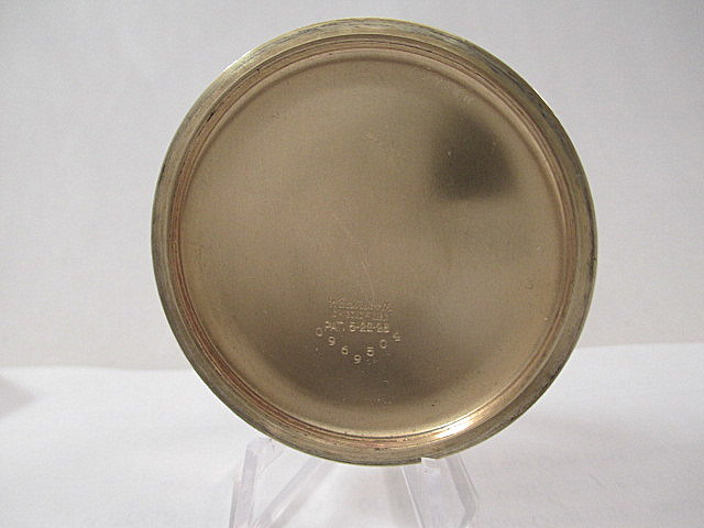

Richard RomeroMichael,
Reading the
Wadsworth-Hamilton Case Numbers History and Database Lindell explains how cases from about 1930-1936 are stamped. NOTE: Around 0500000 the case number layout had changed from straight line to a curved "v-shaped" formation.
Below is a picture of a case stamped as described above.
November 23, 2015, 01:47

Michael P. McNameeRichard, I had meant to also ask about the straight-line case serial number, because I saw on Lindell's Hamilton Wadsworth Case post that Wadsworth had started the V-shape before my watch was made. Thanks for showing your similar example with the straight-line number.
Buster, thanks for the great analysis. It is indeed fun to find an anomaly like this one

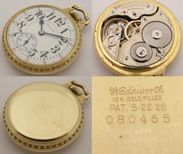

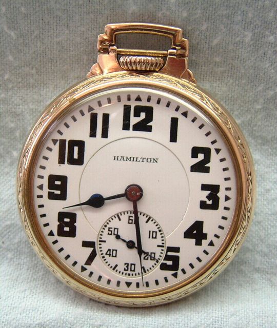

Clark ReedRecent acquisition - I believe this to be the model 530 DOUBLE SUNK dial with Arabic Breguet numerals and the red 5 minute track. This dial was on a Hamilton 992 with a 1,620,xxx serial number.
Thanks to Richard Romero for the data he has mined so well. Hope this one is one of the few with the block signature and red outer track.
Clark Reed

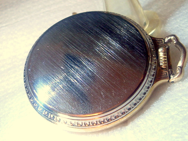

Clark ReedThe back side
Clark Reed

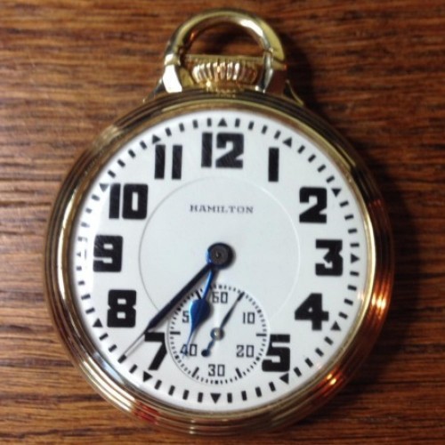

August 12, 2016, 01:15
Clark ReedAnother angle
Clark Reed
