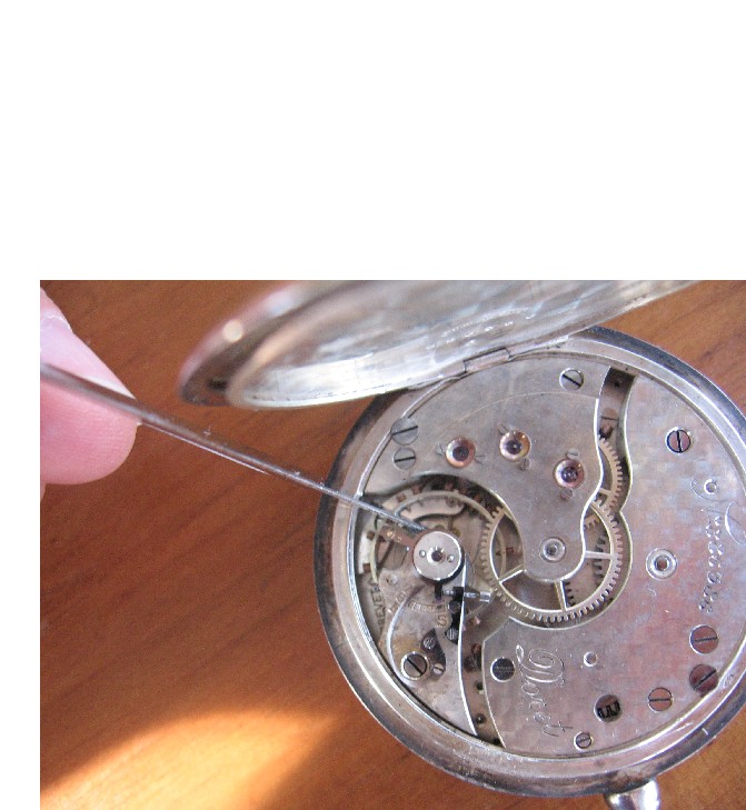

I have one question about this watch.
April 23, 2009, 18:31
Steve Gossard
Why does it have a white balance spring?
April 23, 2009, 18:39
Steve Gossard
I stopped the balance to take a picture, and it appears to be a solid wheel.
April 23, 2009, 19:01
Steve
What is the word inder the balance wheel? I can't make it out.
April 23, 2009, 22:32
Steve Gossard
It says "Brevet."
April 23, 2009, 22:34
Steve Gossard
It definitely has a mono metalic balance wheel. The screws are brass, I think.

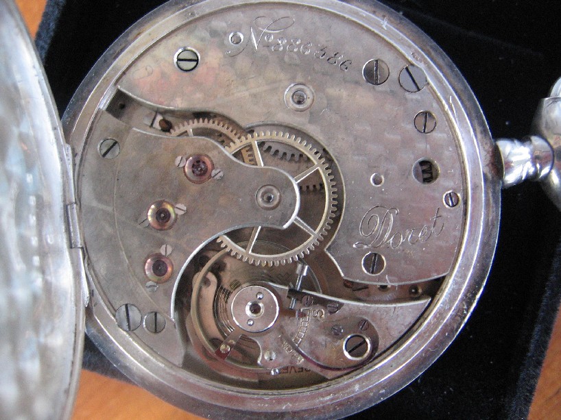

April 24, 2009, 03:22
Mario Pagani
Hi Steve.
I started seeing white hairspings on PWs built during the 2nd WW, and I have just got a Waltham Premier of ca. 1948 in that fashion. On the war-built the reason is simple, cost, they saved the blueing operation. I do not know if this applies to your nice PW, bat it's as far as I can go.
April 24, 2009, 07:11
Steve Gossard
Thanks Mario. That is interesting. It probably dates to the '30s or '40s then.
Steve G.
April 27, 2009, 16:15
Steve Gossard
I think this regulator spring looks like a Zenith, minus the little circular thing-a-ma-jig, but the plate design looks more like an Omega.

April 28, 2009, 21:20
Richard M. Jones
I think Marios point is well taken. At first Elinvar type hairsprings were "blued" so that watchmakers and others would accept them as hairsprings were generally blued. Once the alloy hairsprings were accepted in the 1930's the unnecessary bluing was dropped and WWII hastened it along as I understand it. Nice watch.
